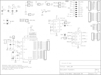

Yeah, a product meant for slow 5 volt Arduino Uno that was never designed to work with a fast 3.3V board like Teensy, indeed does not work with Teensy.
You have two basic options to move forward from here.
1: Abandon it and find something else...
Two problems tend to come up with SD cards used on hardware meant for Arduino Uno.
I tried a quick Google search for "DFrobot_0669 Display" since no info was given about this hardware, and I landed on this page which has a schematic link...

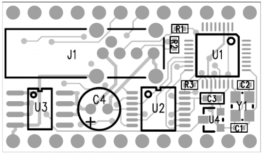

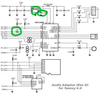

If you buy the voltage regulator, get the "R" version. Full part number is AP7313-18SRG-7. Digikey part number is AP7313-18SRG-7DICT-ND.
https://www.digikey.com/en/products/detail/diodes-incorporated/AP7313-18SRG-7/2270805
Beware the "A"...
Nope, I never made a schematic. Like most PCBs I have made, I create the PCB directly in the layout software without drawing a schematic. I only make a schematic later, if there is a need. If I had a schematic, I would have put it with the...
