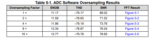

I was being approximate
10.7 ENOB is from https://www.pjrc.com/teensy/IMXRT1060CEC_rev4.pdf

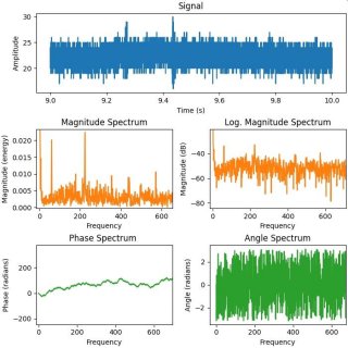

OS typically adds 0.5 bits of resolution for every doubling of the sampling rate, I usually rely on oversampling and exponential averaging / filter - I'm...
Are you still using analogRead()? You should really consider the DMA ADC examples in the Teensy set.
Mine attached does 1.17Mhz (one channel) with no averaging so ~10 real bits and with 8x averaging you should get almost 12 real bits and still...

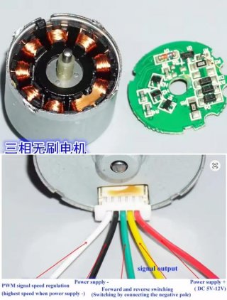

As an update, I'm thinking that the behavior is mostly in the controller of the BLDC (can't update first post now).
"specs" say "PWM signal speed regulation around 10-20kHz" but actually runs from hundreds up to 100kHz.
"signal feedback requires...

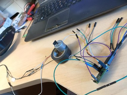

I have a small BLDC motor (5 wire with internal control board) and doing PWM control.
As per the Teensy docs:
Anytime you are doing PWM at high duty cycle it glitches every 4.3-5s, with exactly 500Hz. This is with or without a 4.7k pull-up...

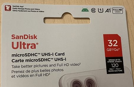

Because that speed is only achievable in UHS-I mode, which requires external circuitry to switch the SD signal voltage from 3.3V to 1.8V.
Otherwise only high speed mode is supported, which runs at 50MHz - with 4 bits of data per clock that's a...

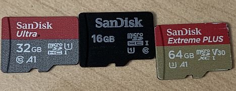

It's from the SanDisk Extreme range, those have better performance than the Ultra series. You can see it has the "U3" marking printed on it instead of "U1".
I just bought/tested a "new" uSD Sandisk 32GB Ultra UHS-1
to compare with older models.
Using SDIO and inserted in solder-on connector to Teensy 4.0.
In left-right order,
SdFat/bench.ino example results:
Use a freshly formatted SD for best...

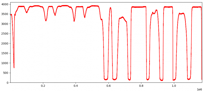

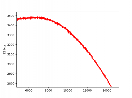

With the main.cpp code RMS noise is ~15 counts at 12 bits and no averaging, 1.17Msamp/s.
Here is one second of photodiode data
no data jumps/missing even at high slew rates:
