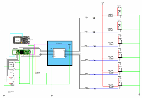

does an undervoltage trash this board too?
it appears that i missed a ground and fed 2V into the 5V pin.

i believe i found the fault that torched the last two boards.

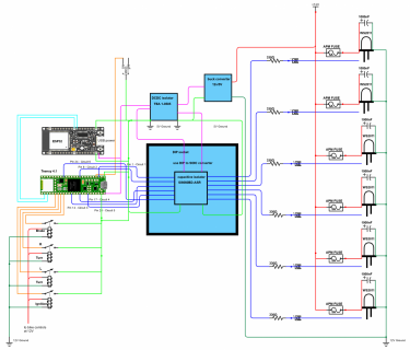

basically, i would need a 12V-5V buck converter to power the isolator on the 12V side or a DC/DC isolator. the DC/DC isolator is probably a bad idea because the existing power method coming off the ESP32 USB could be...

it looks like i could use ISO7710, ISO6760-Q1, or ISO6760L pretty easily. the ISO6760-Q1 seems to be the best option for...

it would probably help if i had far more knowledge than i do. now that i'm looking harder, i'm seeing six channel opto isolators.
so i'll now ask this question:
if i use an opto isolator, to...

supposedly, the circuits are running somewhere around 800kHz. i'd probably have to use a digital one.

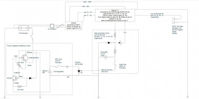

Paul suggested a resistor and diode system that addresses the more expensive problem of killing Teensy boards which i thoroughly explored multiple ideas including the Shottky diode design i found when AI referenced it that i thought might do...
the AI looked at the entirety of my problem statements (blowing the teensy and flickering) and the thoughts i had created with my schematic and pointed out that my schematic was going to produce a lot of heat without a good way to dissipate it...

i did ask the AI about that and the point it made was that the chip is ~$1 and does both the the bump in signal voltage and acts as a sacrificial part. i'm just ordering spares.

i think i've got it all figured out.

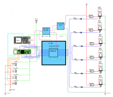

so here's where i'm at.
points of note:
existing -
the entire system functions off of an auxiliary 8AH LiFePO4 battery stuffed into the Windjammer V fairing: all grounds go back to that battery. it has a charge controller and is connected to...

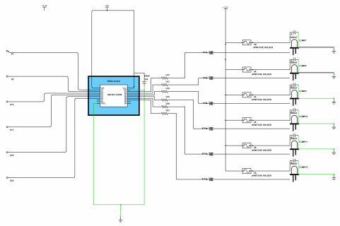

i'm working on doing a schematic. i haven't done one because things were relatively simple, but that ship clearly sailed.
i've discovered a new thing, so what about a TVS diode?
probably not... sounds like something meant for static.
never...
i'm still wondering if the Shottky 3.3V is necessary given my goal is to isolate the data line and suppress any stray power returning. it sounds like sending a fault to the 3.3V pin is just doing the opposite of what i'm trying to do.

i was discussing this with Google's AI because i was looking for ways to isolate and diagnose what happened to the LEDs. the AI found the thread that suggested using Schottky diodes and i asked it if...
so instead of setting up a one way gate with a regular diode, i'd be using one with a squeeze chute going the other way.

so what about the level shifter; is this better than or something that should be used with a level shifter?

are we talking this over a level shifter or in addition to a level shifter?
it's not clear if i am shorting 12V to the data line, but i have a lot of flickering and artifacts in my LEDs, so i am assuming that i need to have a level shifter, even...

the 12V is direct to the strips and does not make contact with the Teensy.
the Teensy is being powered...
