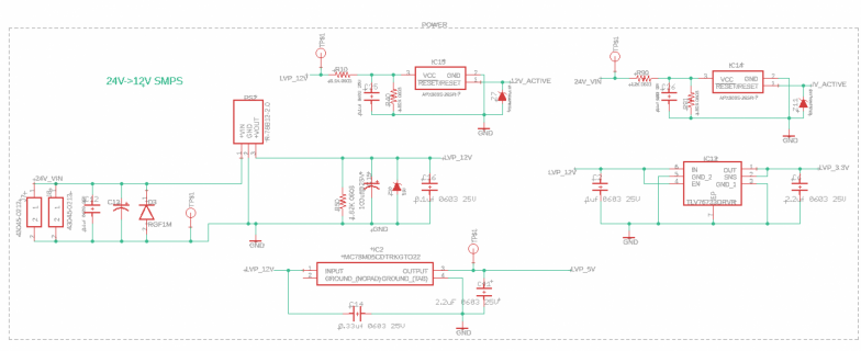

- The 24V base power supply is AC connected, with earth ground

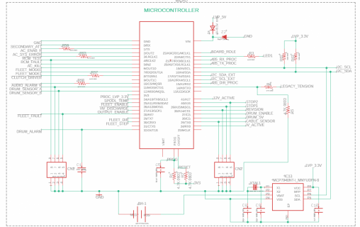

Attached please find the power subsystem, as well as the main processor block. The overall board is fed by a 24V power supply (high quality) which is then broken down into 12, 5 and 3.3V. I will check the 5V startup, but in the past its pretty...

- Our 4.1 design is a full 3.3V compliant design, with 5V translators where appropriate.
- On the diode issue, there was a post in these forums somewhere around backfeed from the 3.3V internal supply...
