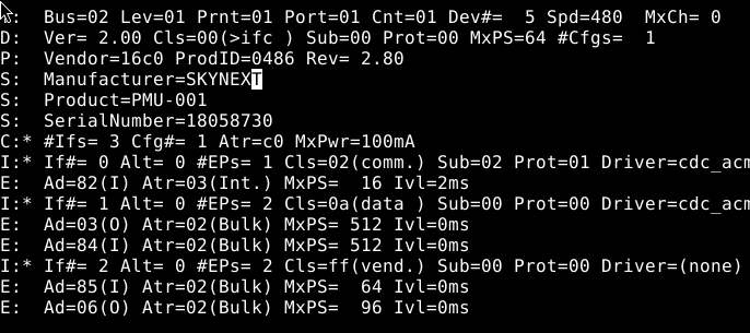

      Just a little update about some issues. First about setting up product id and vendor id It worked best using : in usb_desc.c : #elif defined(USB_VENDOR) #define VENDOR_ID 0x16C0 #define PRODUCT_ID 0x0483 instead of PRODUCT_ID 0x0486...

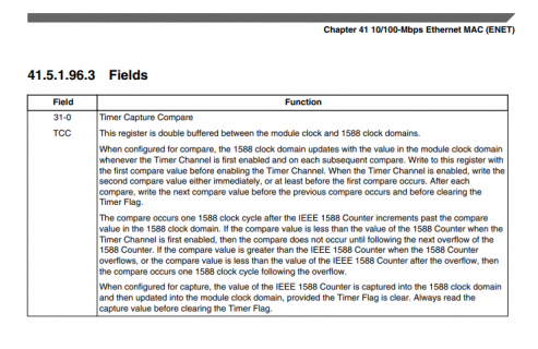

      rodv92 replied to the thread PTP (IEEE 1588) Library.
      The issue is resolved. I forgot to clear the timer TF flag of the corresponding channel, 1 in my case in the ISR. Also, I did not follow the full procedure. The updated working properly full sketch is attached Here is the relevant procedure in...

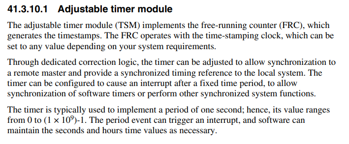

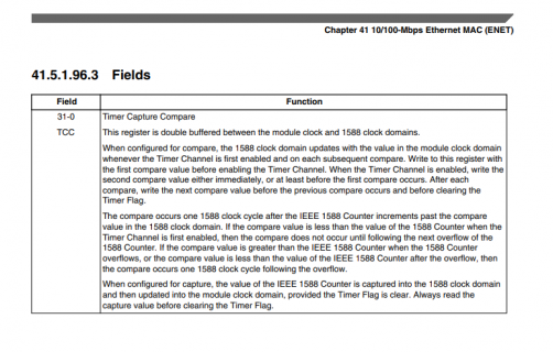

      Well the i.MXRT1060 rev 3 reference manual states that this is a 1ns resolution timer, wrapping at 10e9. I suppose it uses some PLL to increase its clocking to 1Ghz. Extract from the reference manual, page 2115 and later. As for my issue, the...
