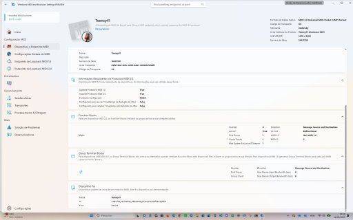

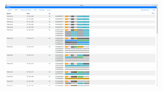

      Closing the validation loop on the Teensy 4.1 MIDI 2.0 device: the cores fork descriptors now pass the two references that matter. Windows MIDI Services (Microsoft's native stack): the Teensy enumerates as a native MIDI 2.0 endpoint over Kernel...
