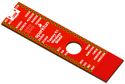

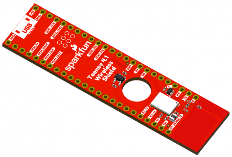

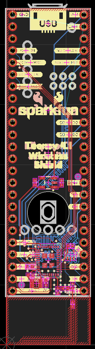

      Apologies for my delay, I had another project taking up all of my time for the last couple weeks, but I'm working on this again! I've updated the design based on feedback here, and polished it up. Please let me know what you think! We'll do an...

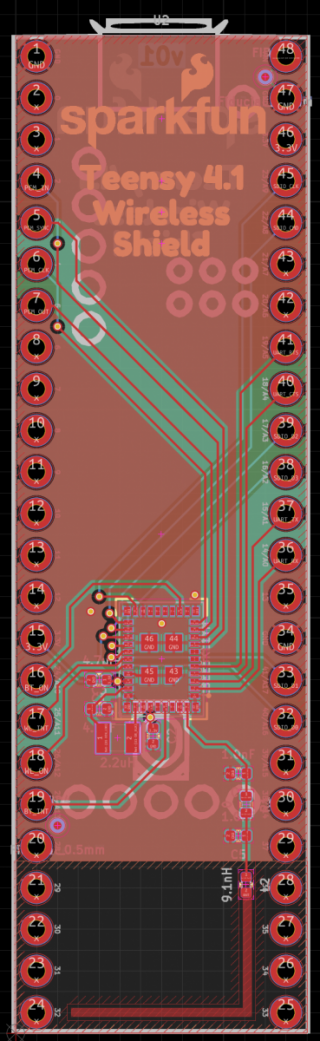

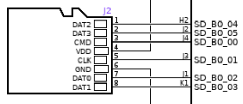

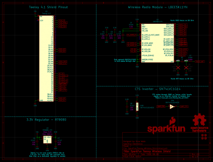

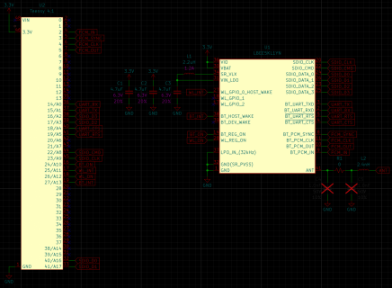

      Very helpful, thank you! Ok, here's a quickly-put-together schematic and board layout. Haven't yet done any controlled impedance or length matching for traces, and definitely need more GND vias. Will do that later, want to first get feedback to...

      @sparkfro - I am trying to find the schematic used for @Dogbone06 1DX board. Don't quote me on this but I think it is HOST_WAKE signal. Our current software is not using the In-band interrupt. //////////////////// // In-band interrupt...
    • sparkfro
      Yep! Though it's the same exact pinout, minus a few pins. From Murata's 1DX and 1YN comparison, the 1DX has the following pins and the 1YN does not (changed to NC): None of those are a dedicated interrupt. From the CYW43439 datasheet, section...

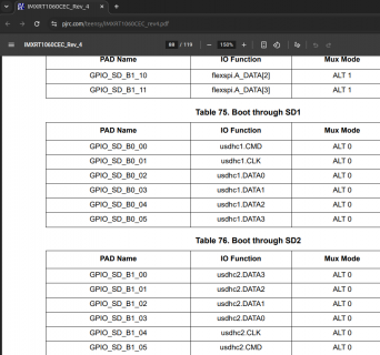

    • sparkfro

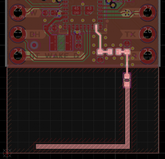

      Oh of course! I should have looked at the reference manual. Thanks for the clarification! FYI I started tinkering with the schematic and board layout. I'm following Murata's 1YN antenna design reference; it fits neatly between the headers, but...
