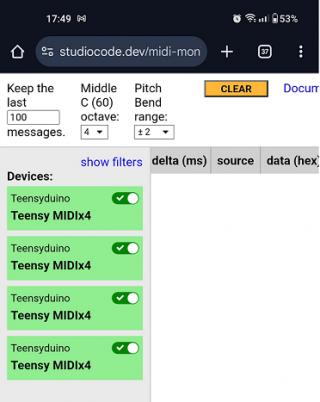

Hello,
I just uploaded the Midi Interface_3x3 Teensy Example with the USB Type set to "MIDI 4" to my Teensy4, plugged the Teensy into my phone (Using a USB C OTG adapter on a OnePlus Nord2) and Android can see it.
I went to this site via Chrome...
