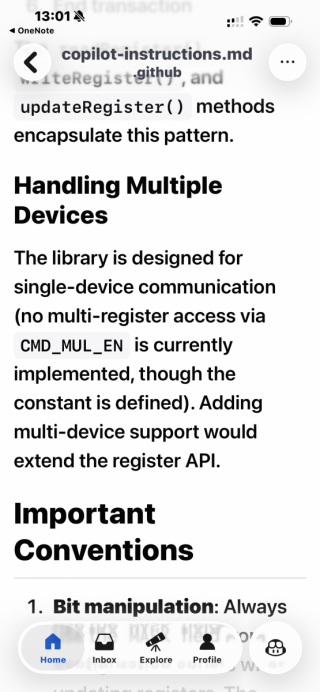

Nope, still struggling here. Looking at the source code it specifically says it does use the CMD_MUL_EN bit if you want a multi-register read; in any case, that’s unrelated to using multiple devices.

Regarding the multi device support, buried in the documentation for the ADS1X58 is this:
If the other library could work with multiple devices that might work. I’ll try to reach out to them per...
I can’t find that statement - can you point us to it?
If you use the alternative constructor you can choose the /CS pin. The author doesn’t seem to have implemented daisy chain support, though. He does still seem to be responsive, despite the...
Well for example, in this library:
https://github.com/TUDA-MUST/ADS1X58
Author states multiple devices are not supported yet even though you can define CS pin.

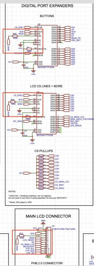

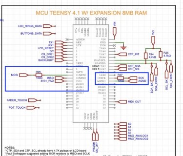

I added it at the Teensy pin instead of the source - see below. Will this work? Or should it be at the other end?
Also, correction from previous post - I got MOSI/MISO lines mixed up.

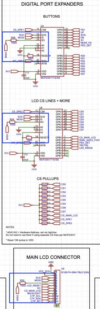

Hi again Paul, I've added the resistors - can you just let me know if I put them in the right place and understood you correctly?
There's also a MISO line on the main LCD so I included that in the schematic snippet below.
Kind thanks!
Mike...
Hi Paul, that is SO helpful! Thank you so much!
When you mention adding the 100R resistors, I'm assuming you mean in-line (serial) with the data lines?
I will take your suggestions on board and test things out.

A couple issues have come up with other projects involving several displays connected to SPI. These may or may not be a problem for you.
Some displays don't properly turn off their MISO pin output driver when their CS pin is high. You can test...

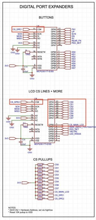

Thanks again Joe. For the CS lines, then yes, all outputs, driving the pins high/low. For the first 23S17, they have a bunch of buttons, so they would be input pins.
Would it be necessary to add external pull-up resistors to those button lines...
That library supports the hardware address feature, so if you find you do need it, it should be easy to use. BTW, I haven't used interrupts on the 23S17. For your purposes, they don't seem necessary. You are using all pins as outputs. Seems like...
Hi Joe, that's super helpful - thank you! Yes it seems to me like using the hardware addresses just adds more complexity, when I could just use two CS pins instead of one on the Teensy. I'm sure I have an extra pin I can use for this, and it...
I have some experience with 23S17. If you have a separate CS to each 23S17, then you don't need to use the address lines. Those allow you to share a CS between multiple 23S17 and address them from within the SPI data. That's a hardware option in...
