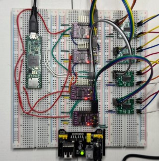

      tref reacted to PaulS's post in the thread Problem with PCM5102A with Like Like.
      Please do so! Otherwise the Teensy signals are floating with respect to the other circuitry. Paul

      tref replied to the thread Problem with PCM5102A.
      No not connected
      #include <Audio.h> AudioInputUSB usb1; AudioOutputI2SOct i2s_oct1; AudioAmplifier amp1; AudioAmplifier amp2; AudioAmplifier amp3; AudioAmplifier amp4; AudioAmplifier amp5; AudioAmplifier amp6; AudioAmplifier amp7; AudioAmplifier...
      Thank you. The module i had came correctly soldered
      It started working suddenly, but still the quality of audio is so bad idk what the reason or where I start.

      tref reacted to KenHahn's post in the thread Problem with PCM5102A with Like Like.
      Grounding the MCLK pin by shorting the solder pads next to that pin to force internal clock generation is how MIcroDexed uses this module in their system which works quite well, so I don't think that would be a factor in why it stopped working...
      I’m using 5v.

      tref posted the thread Problem with PCM5102A in Audio Projects.
      I’m working on an 8-channel audio project with Teensy 4.1 and four PCM5102A DACs using I²S. At first, the DACs weren’t producing any sound even though the wiring was correct. After troubleshooting, I found that grounding the SCK (MCLK) pin made...
