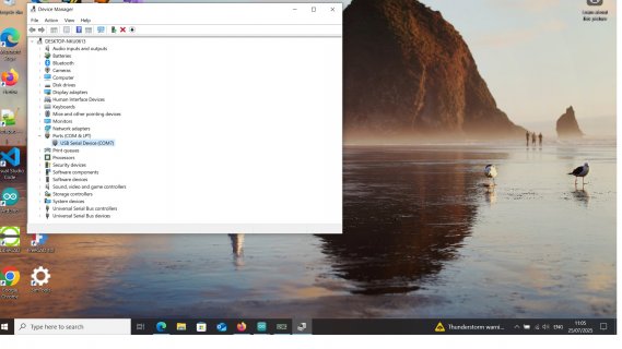

Thank you Paul, your help is more than helpful to me, I really appreciate it. Few weeks ago i installed separate power supply for teensy and left only signals from USB cable, and it works since than without problems, but i was curious why this...
Maybe that is the case, but to be more precise i will explain more in details , 4 stepper motors with drivers and its power supply are controlled by teensy yes, in setup part of program all 4 stepper motors starts to run until they reach upper...
I am looking for help, I am using teensy 4.0 on my project kind of CNC machine with 4 stepper motors, I made software on my Lenovo laptop, test it all good, all runs perfectly every time, than after 2 months of no problems suddenly when i...

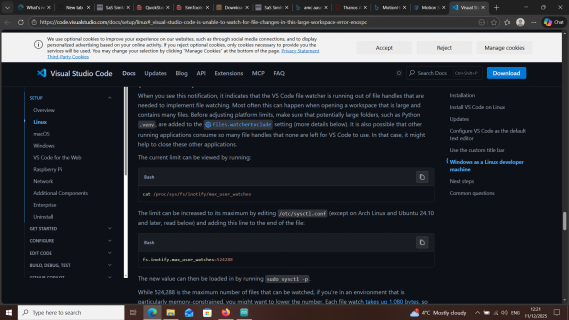

Arduino button didnt took me... Message was displayed at the bottom right corner of Arduino IDE same as in Arduino IDE no internet connection or update available and similar, so I clicked on it and it took me to Visual studio code website,...
