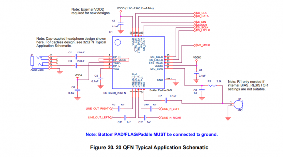

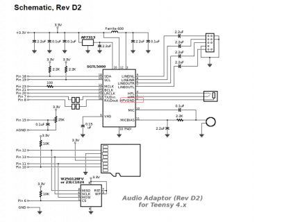

Notice that the Teensy Audio Adapter does not have any capacitors between the SGTL5000 & the headphone jack. Also take note of the statement on the snipped example schematic that you...
I'll try to explain, because the datasheet probably doesn't make this clear...
Like pretty much all audio chips with single power supply, the audio signals have a DC bias. It's approx 1.5V to 1.6V for chips running from 3.3V, though the exact...

However, I'm quite confused: in the schematic of the Audio Adaptor Boards for Teensy, HP_VGND is connected to the headphones, instead of being left floating as in the classic example from the SGTL5000 datasheet.
