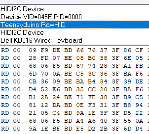

Hello,
I'm reading data from an accelerometer (Adafruit_LSM6DSOX) connected to a Teensy 4.0. I am then transmitting this data to windows under RawHID. This works. I have the Arduino IDE up, and the data is getting transmitted well. I verified...
