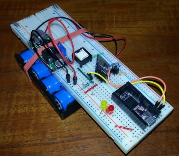

For me the Teensy 3 is ideal for a host controller and since it is a 3.3 volt device, it is directly compatible.
I am hoping to pull the information together in one place to save others the frustration I had getting started.

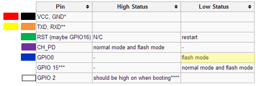

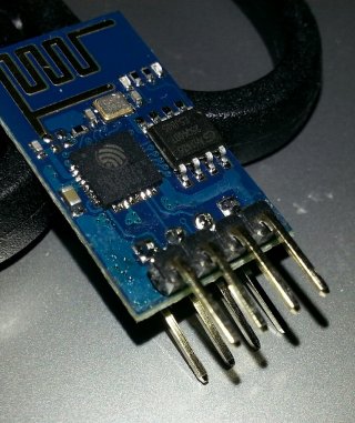

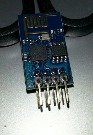

These images show the pinouts and connections of a commonly available ESP8266 Breakout board.

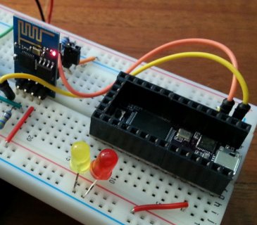

Using the Hardware serial port on the Teensy and USB serial port
ESP TX -> Teensy Pin0
ESP RX -> Teensy Pin1
