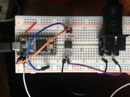

dimitre
Midi in is actually working! Please let me know if I mounted it right, the diode position, etc.
Thank you
I don't see a resistor from pin 4 but the signal diode looks to be reverse biased as it should.

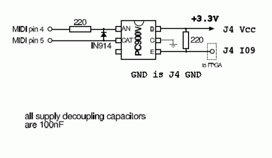

I would not recommend following the advice from that blog. There is very little difference between using two 47 ohm resistors versus 10 and 33 ohms. But using 220 and running the transmit pin directly to the cable without any resistor is not good. 5.6K for the pullup is also not good advice. These may work some times, but they are far outside the recommended range.
But even though it's 'wrong' it likely still works with most configurations... the receiving circuitry is pretty resilient to current variation on most receivers.

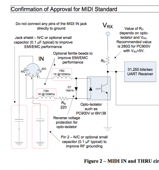

I'm not sure what spec you're referring to for the diode but it's just there for a bit of polarity protection so I think that's OK.
I'm not an EE... but I think both Paul's and the MIDI spec are fine... I'd go with MIDI because it is the standard.
(Ah ...someone that does know got here first... )
I suspected it... asked just to be sure.
The optocoupler 6n137..

I still don't understand if the 6n137 works with 3.3v. In some datasheet is 4.5-5.5 but in others like this: 6N137.pdf is 3.3v capable..
mine is anonymous.. who knows.. we'll see..
Daniele.
I'm using Sharp PC-900V and working flawless.
From what I've seen from the Midi documentation both are acceptable
"opto-isolator (a light emitting diode and a photo sensor which share a single, sealed package). Sharp PC-900V and HP 6N138 opto-isolators have been found acceptable."
