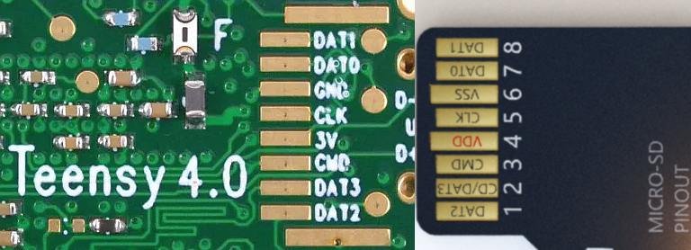

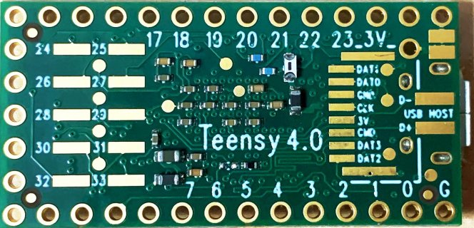

1.0mm breakout connector for the Teensy 4.0 uSD pads ?

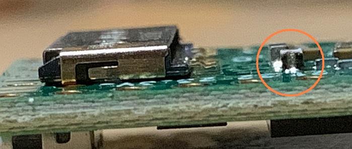

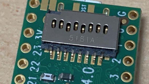

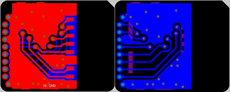

The Molex 1051620001 arrived and I soldered one on.
FYI this really calls for solder paste and a microscope.
I bent 1,2 & 7,8 inwards a tad, soldered and had to use wick to remove excess on a couple.
The mechanical issue is that the card rubs on the 2 SMDs
and needs tape under it so as not to contact various pads, as well as glue to hold it down securely.
I never did figure out what device was designed to go there, unless is was a ribbon connector.
As someone pointed out, the part is 1.1mm pitch, while the pads are 1.0mm
Huh? Feels like we're talking in circles here.
They were talking about the molex connector that you ended up buying. The flex ribbon connector that the pads are actually designed for is this one, which has 1.0mm pitch and is used with the breakout board.
Not the ideal solution, but in some situations might be enough - made this some time ago and have been using for over a year now.
T40 SDIO << link to github repo
Is it my imagination, or, is the connector mounted 180 degrees the wrong way and now the SD signals are 180 degrees incorrectly connected to Teensy?
I had to think on that too
What Pio does with his (very nice) board is swap using 2 layers:

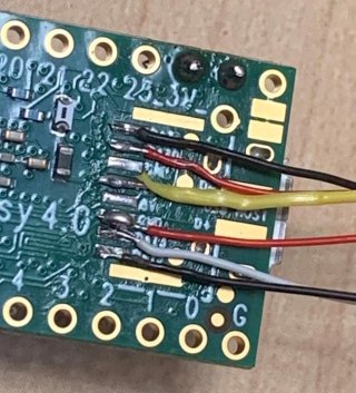

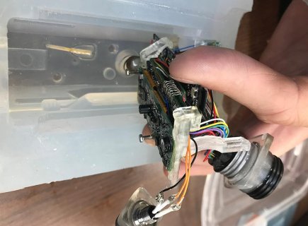

We have also ground down board edges to create castellations, but if pre-populated we used stripped 30ga as jumpers - Bill was worried about static during grinding:
(That was MSP430 based deep sea camera)
