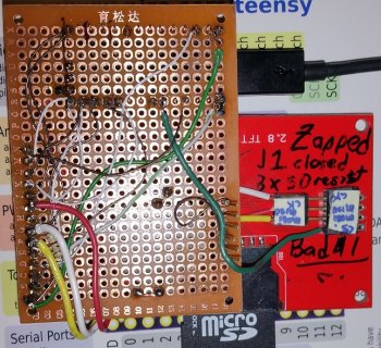

I got mine working! Followed the linked edits indicated - Solder over J1 and wire jumper replace the three resistors going to SD.
I took the common SPI lines to my shared Touch and 9341 lines (no pullups on this board) to the three SPI lines Miso/Mosi/Clk and then added CS:
* SD card attached to SPI bus as follows:

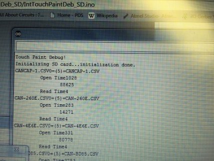

I took and SdFileListDump.ino and dropped at the bottom of my IntTouchPaintDeb.ino and has main setup call the renamed SD setup2() and it worked! I even called it within the touch code and it runs to USB out.
This is the display that was not getting VCC until soldered over the J1 - it is now working in full for the last 24 hours. The SD card I picked has dozens of files and it did a good directory.
NOTE: When the TOUCH triggers I queue a read for the next user code query. It does not complete a read during the interrupt. It is up to the user code to request data when the code is ready to read it. As it exists the Interrupt code prevents the need for user polling until a Touch happens - but without implementing a user callback I can't force the user code to act on it until it sees the flag by asking for a point. And my debounce code requires two reads about the same pixel to call it good to return. Unless I make it read and buffer a few points to return - until the user code calls the touch is lost.

Here is a pic with the SD lines in place. They are plugged into a header to make them removable. I also did the touch_int to pin 2 before the pic, and it works.
<edit this ugly board also has a battery and RTC clock
I now have the PJRC OSH board and PSupp parts for the touch so I'll build a better one.
The code I used is on : github.com XPT2046_Touch_Examples/ /IntTouchPaintDeb_SD/IntTouchPaintDeb_SD.ino
It shows that I implemented interrupts about halfway. Touch is detected - but not acted on until user code asks. I may look to fix that - but I had issues and what went stable works like this - because of how I do the Touch reading and worked around the interrupt during interrupt re-entrancy prevention.
