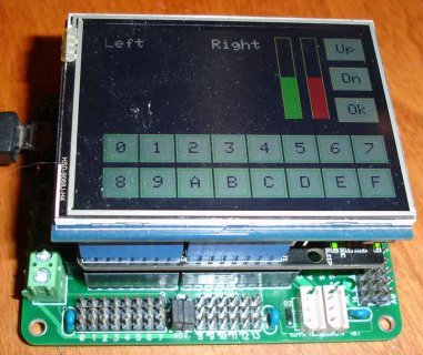

Not sure if it is interesting or not, but I hacked up an old test program that I would probably rewrite, but it had some buttons and slider like objects, and I hacked it up to use the XPT... controller. It is a multi-tab sketch. At the time I was working on maybe abstracting away which display... So the code is convoluted.
But it sort of works... Nothing is hooked up to buttons here... Except I think the UP/Down buttons sort of go to new displays...
This code was originally some stuff I was doing for my Teensy DIY XBEE remote control, where I have real sliders, keypad, 3 axis joysticks...
The file display.h has the defines for which pins I am using on my display and touch...
Again it ain't much. I am sure there are much better libraries available
