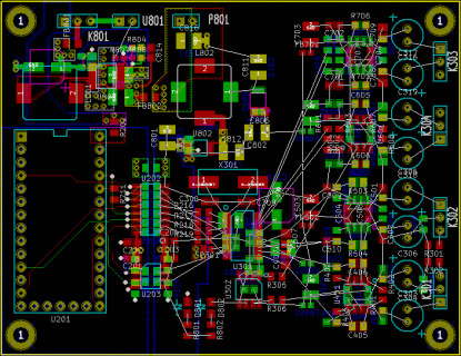

I'm still working on the layout, but I hope to have it done pretty soon, and maybe off to fab in less than a week.
Here's what it's looking like so far:

Thanks for catching that, Paul. I hadn't thought of that at all. I'll probably turn around the Teensy so that the USB cable is at the edge of the board.

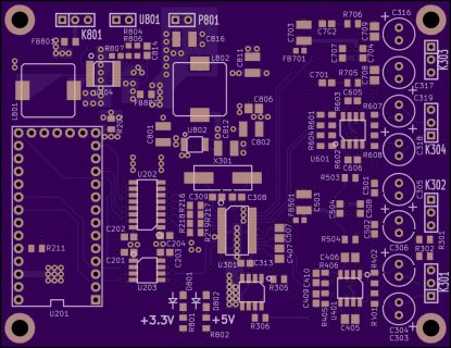

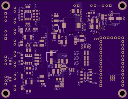

I finished double checking everything last night and submitted the board to oshpark, so hopefully I'll have a proto board in hand by mid-march.
Any chance to see how it turned out? Or a share on OSH Park?
Really, I can understand how you'd want to keep it under wraps until it's tested. That's what I normally do.
But if you're willing so show, I'm curious to see it. ;)
I don't really want to share it yet on oshpark, but here are the images that they generate automatically:
Top:
Bottom:
The two inner layers aren't that interesting anyway, they're just the ground plane (continuous except for isolated area under the Teensy and cutout underneath the crystal) and the "power" plane (not continuous, with a few signals to keep it interesting).
I just got all the parts on Friday to double check the footprints, and a bunch of new soldering equipment today, so I'm eager to actually start work on it, and waiting the 2-3 weeks for the boards to get back is going to be pretty difficult :)
Looks like no solder mask between the fine pitch SMT pins. That's going to make soldering those more... interesting.
OSH Park solder mask cuts only need to be about 5 mil oversized from the pads. I know that might seem like not allowing much tolerance, but OSH Park uses very good USA fabs that hold tight tolerances. If you make more, I'd recommend adjusting the settings so you get a thin strip of solder mask between those pins. I've made many boards with 0.5 mm pitch pads where OSH Park was very capable of this.
It's good to know that OSH park can handle those kinds of spacings. I've used advanced circuits in the past, so I used their freedfm.com check as a sanity check, but it sounds like they can't handle the same solder mask tolerances.
I'm also relatively new to KiCad, so I may have inadvertently doubled the actual soldermask relief from the freedfm recommendations (6 mils instead of 3).

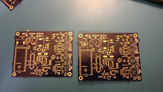

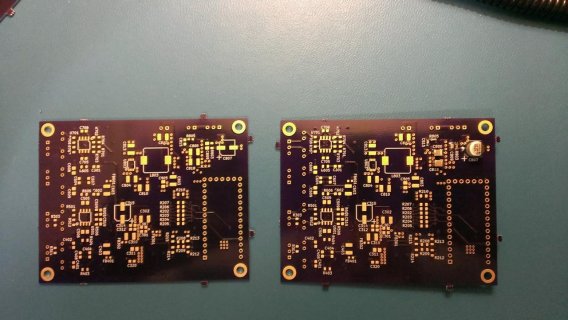

On another note, I received a set of boards back from OSH Park, and am starting to assemble it. The 0.635mm pitch on the smt parts is a good challenge for my rusty SMT soldering skills (especially without the flux that I forgot to order). Hopefully the rest of the fine pitch ICs will go better once the flux gets here.
The switching regulator seems to be working ok in spite of my ugly soldering job!
