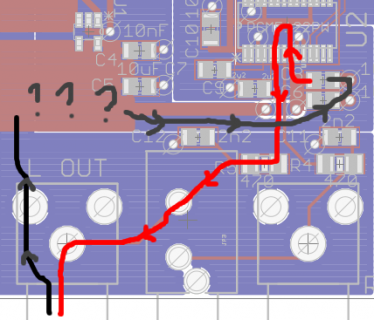

Just with a quick look, the grounding looks strange to me. But on the other hand, professionally I designed circuits up to 120 GHz, so I lost the ability to see a PCB just as a connection, I am always thinking in E/H-fields, instead of a normal voltages/currents.
The analog signal is the most important signal. I drew the current the signal follows. Starting from the power supply capacitor to the IC, then from the connector and all the way back. You would want to make this loop as small as possible, to prevent any RFI/noise etc from entering the line. In general for these kind of lines, there should be a ground return path underneath, without any other line crossing the ground.
Furthermore, I do not really see the ground strategy. I would put the 'star ground' underneath the pcm5122.
From a filtering perspective you will always want to force the current over the capacitor. I do not know if you need the planes near the regulator for dissipation, If you need it, I would put slots in it, to force the current over the capacitors. Likewise, I would route the trace from R5 to C12, and then from the C12 pad to the connector, but like I sai, this is probably the RF engineer in me. Another thing about the capacitors, you will always want to place then with the smallest values near the IC, so swap C6 and C8.
Edit: I only drew the loop for the L-signal. If you imagine a similar loop that the R-signal will follow, you see both loops overlapping, thereby reducing the isolation between both signals.

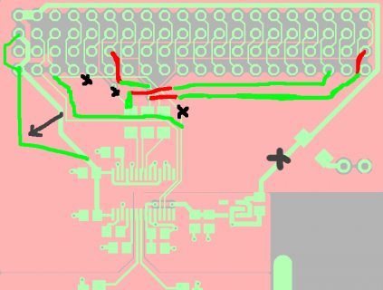

Thanks for the instruction. I really appreciate it. Yes, this is a dedicated digital to analog device (playback only). No analog in to deal with.
My (faulty) logic was to split the ground on the bottom and connect the analog and digital at J1. The ??? on your jpg refers the portion of the analog ground plane which is split from the output ground and connects at J1.
My 'strategy' was 3 separate the ground from the star at J1: one f for the PCM5122 Digital ground, analog supply ground and analog output ground and all meeting at J1. It is unclear on the PDF, but that is the layout. The large + fill is not needed, I can delete it and just use a large-ish trace for the analog + rail. From your comment,. though, my R ground will always cross the L signal unless I have a separate L and R ground traces on the bottom which do not cross. Is that what you mean?
I will noodle on this a bit... If I rotate the chip 90 deg, I can shorten the analog outs, and keep the + rail from crossing the outputs but the SDA/SCL will cross them. I'll try again, but with the star at the PCM5122 and see what it looks like.
Thanks!
Keith

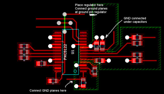

I played a little with the layout as well. It is just a rough sketch.
I am not very proud of it.
The SDA/SCL crossing can indeed not be prevented. But then again these lines should be static when audio is playing.
I assume ground plane anywhere. The special zones are indicated with the green haching, as well as where they should be connected. In principle no line should cross a gap between groundplanes.
I am a bit unsure about Vneg. I assume it to be used for the analog stuff, so I also included the analog groundplane underneath it. Or is this voltage part of the charge pump?

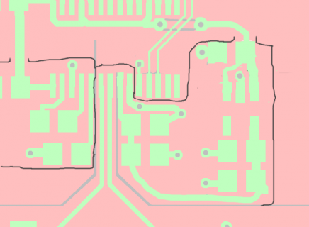

Although the digital side is not very critical, I would align the digital signals with the connector where there is still round, instead of underneath the connectors.
Furthermore, I would give the power supply a little more space wrt the I2C.
I would also keep the I2C signals together.
I personally do not like the big loop the power supply takes.
As for the analog power supply, I see the clean power supply crosses the I2C signals. I would only allow it to cros the digital power supply
I would also keep the digital ground pin attached to the digital ground and the analog ground pin connected to the analog ground. (I hope the chip designers also kept it separate internally)
The input of the power supply crosses a gap. This is (almost) never a good idea. In principle there should always be a return path near the signal.
You can rotate the power supply 90 deg CCW. I kept the decoupling the same, but as there are now 4 C's at the output close together, I would move one of these C' as a 10/100nF input decoupling C, with the ground on the digital side, as this is where the noise is coming from, therefore the current should short this noise to its own local ground.
Finally, I would keep the charge pump also on its own ground.
Edit: I would also place capacitor at the (optional) power supply input, before the diode. I suppose there will be long leads attached, so it will be perfect as an antenna for picking up mobile phone signals. I do not know where you live, but here in Europe with GSM, all cheap audio stuff will perfectly detect the mobile phone signals. You want to short circuit these signals with a 100p...1nF capacitor.
The audio lines will also have the same problem, but these already have the capacitors.

Thanks again. I think I follow most of your suggestions, but a couple have me stumped.
"but as there are now 4 C's at the output close together, I would move one of these C' as a 10/100nF input decoupling C"
The supply has 10uf/10nf on its output and the chip has 10uf/10nf as well. Do you suggest only having the pair at the DAC chip grounded to the digital instead of analog ground? My current layout does not show this, but it is easily done.
The other is the 5V lead. I need the 5V lead from pin2 on the 40 pin connector to supply the 3v3 regulator. You showed it connected to the 3v3 digital supply which I am pretty sure will not work. Your comment that it is a long run around the 40 pin connector, I get. Is it better to have a long run like that or to run it on the bottom and cut a slot in the digital ground? The only other way I can see it is to have a jumper on the board but do not know if that is even worse. Regardless, I added a small cap to digital ground for the alternate 5V input (J1). I do not intend to use it right now, but could, in the future, use a more appropriate supply on these pins to power the system (board and Pi).
Also, you showed pin VCOM (pin 10) connected to the digital ground. As I read the data sheet, it seems like this should be connected to the analog ground, but maybe I misunderstand. I interpret this as the ground connection for single ended instead of balanced output...
Are the grounds connected correctly, now?
