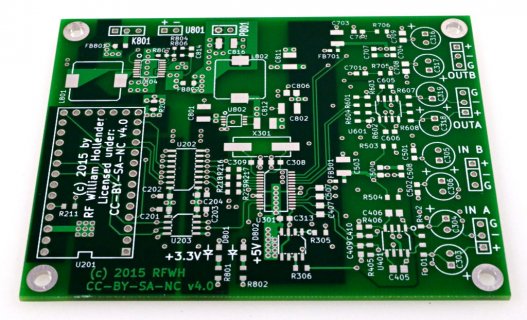

One of the few things that I changed was an update to those pads to make the positive side of the output caps square instead of round to make the polarity clearer, but I must not have re-generated the planes afterwards.
The files are updated in github and there's a new oshpark project https://oshpark.com/projects/63HpdGfx
Paul, I have an extra board from my original build that I'd be willing to send you if you'd like to get started a bit faster.

I sent the revised files. I looked at them only briefly, to make sure I had the fixed version and they weren't corrupt. But I didn't do any sort of DRC check or trace out connectivity or compare with the schematic. I just sent the revised files. We're going to get 10 boards with whatever those files specify!

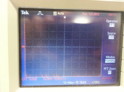

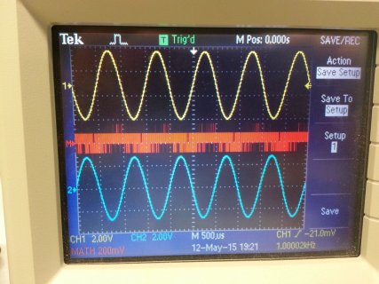

I did some testing tonight. I did not have a spare SD cars, so no grabs. I did photo the scope. Will try to do it again tomorrow. I will need help interpreting. 2 pics attached. 1 of the 2 channels combined and the other which shows the output of 1 channel driven at 0 and the other channel driven full at 1k.

In the right picture it looks like you are adding the signals with the oscilloscope in the digital domain.
Oscilloscopes in general have very bad dynamic range. To increase the dynamic range, somehow you have to remove the fundamental tone. This is either by filteing, or by cancelling. This should be performed in the analog domain. Only after that it can be sampled.
