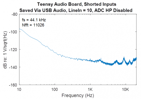

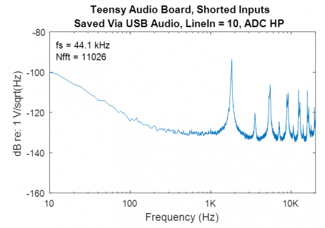

Ironically, the sgtl5000's high-pass filter was introducing a lot of high-end noise, so running adcHighPassFilterDisable() helped (and it seems that you do have to run it explicitly – it appears to be on by default).
In testing with my Teensy 3.2 with Line-In (shorted), I get a whining squeal that jitters about. I did the adcHighPassFilterDisable() and that noise goes away. Shocking! Awesome!

To document my own experience with the noise of the Teensy Audio Board (and to show the positive effect of disabling the SGTL5000 ADC's high-pass filter), I wrote it up here:
http://openaudio.blogspot.com/2017/03/teensy-audio-board-self-noise.html
Audio samples are shared on that page, along with spectra comparing "with HP" and "without HP". That high-pass filter is adds a lot of squeeling whiney noise!

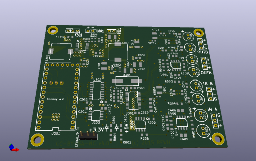

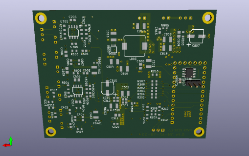

Played little bit in Kicad using whollender CS4272 design files. This PCB is too complicated, it could as well be double layer and without those RF isolators (those are fancy though, I didn't even know such exist). I just edited netlist manually as the input from schematic didn't seem to work. Also added manually S/PDIF pins, MIDI and SRAM. Might consider making the PCB somewhere where you can get 4-layer board for low price if I can find such one.

I might still move the codec to I2S2 as it would free up the main I2S for multi-channel use. Unfortunately every connection (I2S lines) from the isolator to Teensy crosses over each other (pinout is reversed kind of). Also for the I2S2 master clock there are no pins on the header. In this design the CS4272 is master, though if you leave out the isolator you can bypass it using resistors (0 ohms or greater when needed for the signal integrity). Then it's also possible to change the direction for the clocks and use I2S1 MCLK output from Teensy, then you can also save some costs as the local oscillator is not needed. The board is so tightly populated that it would be difficult to convert it to 2-layer one, the ground zone would be quite broken at least on top side.
Yes, moving to I2S2 might be a good idea - though I'm not sure how much editing of the library routines might be required.
Using the 6/8 channel board and TDM could produce the same result as multi-channeling with several boards, and with much less complexity. BTW my CS42448 boards are busy swimming toward me from the aforementioned Chinese PCB company, and I'm happy to send you one, as I'll have some spares. Also happy to share the Eagle files if that's any use (I think you have mentioned you use KICAD).
