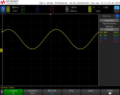

I am looking to drive a current amplified (sloooow) sine wave audio signal coming from the teensy on the order of .1hz. But the teensy audio library doesn't really support this frequency in a sine tone from what I can tell.
How did you arrive at that conclusion?! The audio library does indeed support low frequency synthesis.
First, watch the tutorial video. The part about oscillators begins at 25:04. You can see the use of an oscillator as a LFO in this tutorial. There's no dedicated LFO object, because all the oscillators support low frequency.
As a quick check, I just tried this:
#include <SerialFlash.h>
AudioSynthWaveformSine   sine1;          //xy=170,106
AudioOutputAnalog        dac1;           //xy=341,120
AudioConnection          patchCord1(sine1, dac1);
  AudioMemory(8);
  sine1.amplitude(0.9);
  sine1.frequency(0.1);
It does indeed work. Here's the waveform at the DAC pin. Notice the time scale is 2 seconds per division...
The one important caveat is you must use the DAC without a capacitor. The audio shield has 2.2uF capacitors. If you try this with the audio shield, you'll need to modify the hardware. The library will produce the 0.1 Hz signal, but you need to connect without the capacitor to actually get access to it.
