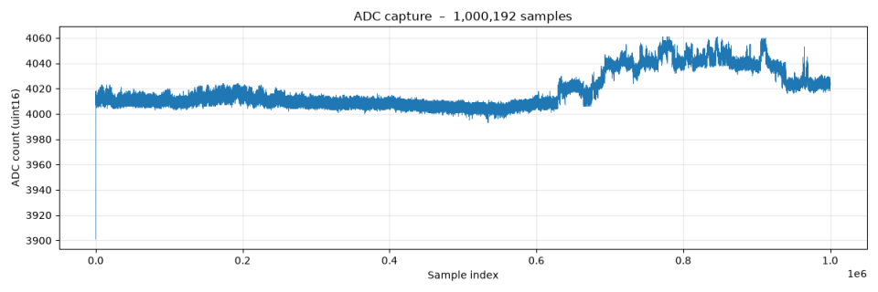

I looped the 3.3 V pin to A0, the board is powered by USB/laptop.
I have a new streaming .cpp code which streams one channel of data at 150k back to the laptop running Python serial capture.
It appears to vary from ~3.22 to 3.26V - does that seem typical?
[teensy] dmaCount: 3910
[teensy] maxBytesUsed: 14848
[teensy] elapsed: 6.834 s
[teensy] avg sample rate: 146.5 ksamp/sec
[teensy]
[teensy] Enter to stream again
Captured 1,000,192 samples (1953.5 kB)
min=3901 max=4061 mean=4019.1 std=14.7
BTW, the .cpp is attached, and serial cap code is below (can't attach...).
Output is 1339.4 ksamp/sec streaming uint32 over USB 2

As one might expect, the STD rises with rate (12 bit counts):
[teensy] avg sample rate: 167.4 ksamp/sec
min=412 max=429 mean=421.1 std=1.7
[teensy] avg sample rate: 334.8 ksamp/sec
min=410 max=431 mean=421.7 std=2.1
[teensy] avg sample rate: 1339.3 ksamp/sec
min=389 max=448 mean=421.5 std=3.4
I'm curious what the measurements would look like if you sampled the 3.3V with a different Teensy. (Sharing grounds, of course.)
I think I have another to try. I don't have a scope but do have a nice AS-1250 ADC to check the pin V separately. The STD is small.
A 3V battery would be a good test too.
Part of the idea here is to turn any Teensy into a 1.3 MHz triggered O-scope, and I'll put a Zener and resistor on A0 to test simple front-end protection. Maybe a cap to limit aliasing, we'll see.
