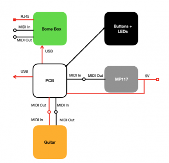

I have a question regarding power :
I am building a MIDI controller and I want to connect it in 3 different ways : USB, MIDI and Ethernet
My idea is to use a Teensy and a Bome Box, which has Power Over Ethernet.
I will have 3 different options to power the Teensy :
- from the USB when connected to the Bome Box's POE
- from the USB itself when no Ethernet cable is connected to the Bome Box
- from an external power supply (9V lowered to 5V)
how can I implement that and make sure I am not going to damage the Teensy ?
