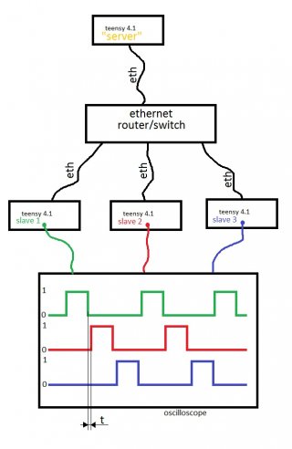

Hello.
I'm working on fmcw radar system.
Radars are working on the same frequency, thus they need to be switched on and off so that only one radar transmits at any moment "time domain multiplexing".
I'm using teensy 4.1 boards to control each radar.
Each teensy board is connected to a ethernet switch or router (they are connected in one network).
I need a server board that will send "allow" signals to each slave. And after slave receives this signal, it turns high one of GPIO ports for fixed and hardcoded period of time "eg. 100uS".
I could use standard udp packets etc, but it turns out to be not very reliable way to achieve this because there is huge delay.
I need time "t" showed on scheme below to be 1us or less.
Scheme:
Please guide me if PTP is the way to go here? Does Native Ethernet library for teensy 4.1 works with PTP and how to use it?

I'm not sure Ethernet is the way to go to get 1 us control of your slaves. Any way to have digital connections from master to each of the slaves?
T4.1 does support PTP, see
https://forum.pjrc.com/threads/61581-Teensy-4-1-NTP-server
ddrown's 1088 support in the NTP server is using lwIP lib. I don't believe NativeEthernet lib has provided support for PTP/1088.
You might be able to use ethernet multicast. Your master could send out a multicast packet to initiate a transmit sequence. each slave would receive the multicast at the "same time" and schedule their pulse based on their "slave number"
ddrown might be able to suggest how to use PTP to get the "time" on each slave closely sync'd,. then master could provide a pulse time to each slave, or?

Each radar is controlled by single teensy, almost all pins are used for that (28 pins are used for ADC 2x14bit, others are for clocks, spi, enabling tx, etc, etc...).
Each radar can be up to 50 meters (165ft) apart, without common ground.
If not ethernet, i thought about just using "non used" pairs of Ethernet cable (100Base-T is uses only 2 pairs), and place separate teensy near ethernet switch, just to control timing for each radar by dedicated lines. Altohugh this idea might seem okay, I think sending asymmetric 10khz 3,3v signal through 50m will be a disaster, so we need more circuitry to make this signal symmetrical and higher voltage. Maybe RS-485 is the way to go?
I would go with shielded RS-485. It's already engineered by supercool EE geniuses as a finished product, and it supports enormous runs (way bigger than you need.)
With some kind of twisted pair, you might do okay, but you would want it shielded so it doesn't pick up every AM radio station and doorbell. I don't know enough about the engineering, if you have to debounce it, etc. Cat-5 is rated for 100 meters, and you don't need huge frequency anyway, so it might be okay. On the plus side, the Ethernet connection for the Teensy 4.1 doesn't support PoE; but if you don't use it, you could run power over some unused pairs. (Seriously, PoE would be INCREDIBLE with these!)
Finally, you could keep the clocks in sync with the precision timestamp thing, but I don't know if the Ethernet implementation is buffering data for you. If it isn't, and you have to let it raise an IRQ any time it feels like it, it might step on your radar task. You might even have to shut down the antenna until it finishes, twice an hour or however often you want to sync it up.
To me, the Ethernet solution doesn't carry power, so you have to do that separately, so it's the same problem you have with RS485... and RS485 is already a finished product that will politely buffer some data for you. Someone has already done the engineering for you, and you don't have to worry about the Ethernet/TCP stack stepping on your main task.
A good implementation of PTP "should" be able to achieve sub-microsecond timing synchronization over a LAN. Agilent said in 2005 their experience with PTP / IEEE1588 is ~ 0.1 microsecond accuracy with a lightly loaded LAN and whatever hardware they think of as "inexpensive oscillators". BUT I am not aware of a full implementation of a PTP client for Teensy yet, although there's been recent work done on a PTP server. Also I do not think any LAN has microsecond latency, PTP only gives you local clocks that are aligned. So you have to map out and distribute a schedule ahead of time, about which microseconds at some point in the future each node is permitted to transmit. https://www.nist.gov/system/files/documents/el/isd/ieee/tutorial-basic.pdf
RS485 does sound like a pretty good approach. If using the CAT5 cables, you might have one pair for bidirectional data and perhaps dedicate a pair for a simple unidirection pulse from the server to the 3 radar sites. You could just use GPIO for the pulse, so something like attachInterrupt could give you a very rapid response at all 3 locations when it's received.
