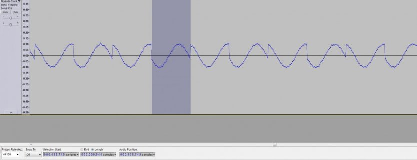

I am trying to modify the audio library to support 4 channels with 24bit-depth. I basically have 32bits samples that I cut to 24 later.
I am very close to get everything working, however the input signal is not correct. There seems to be an overlap in the buffers somewhere, see screenshot of a pure-tone sine wave. The number of samples selected corresponds to the FRAME_BY_BLOCK size.

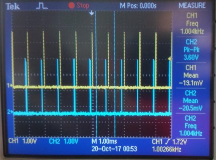

The I2S buffer seems to operate at the same speed as the USB buffer, but could be slightly out of phase (1kHz I2S and 1kHz USB, see screenshot).
I think the problem could be caused by a setting in the DMA, however I don't fully understand what I have to use for the modulo (SMOD and DMOD). I tried a few settings but they end up crashing the Teensy. If you think it would be caused by something else let me know.

Screenshot of USB vs I2S
Screenshot of a 1kHz pure-tone sent to 1 input and recorded in audacity
