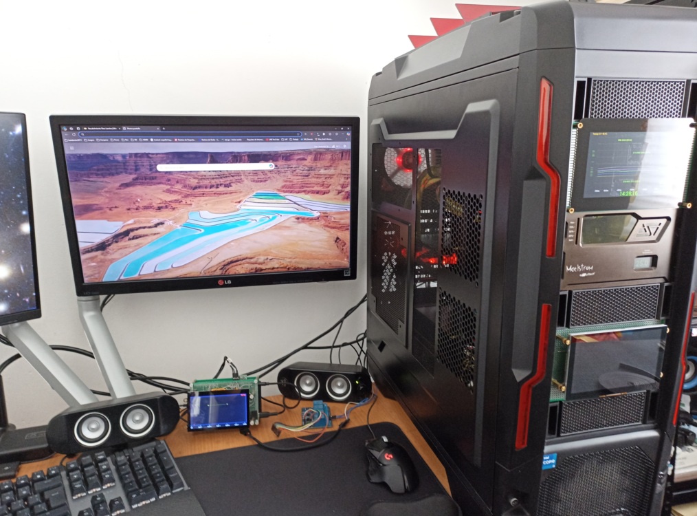

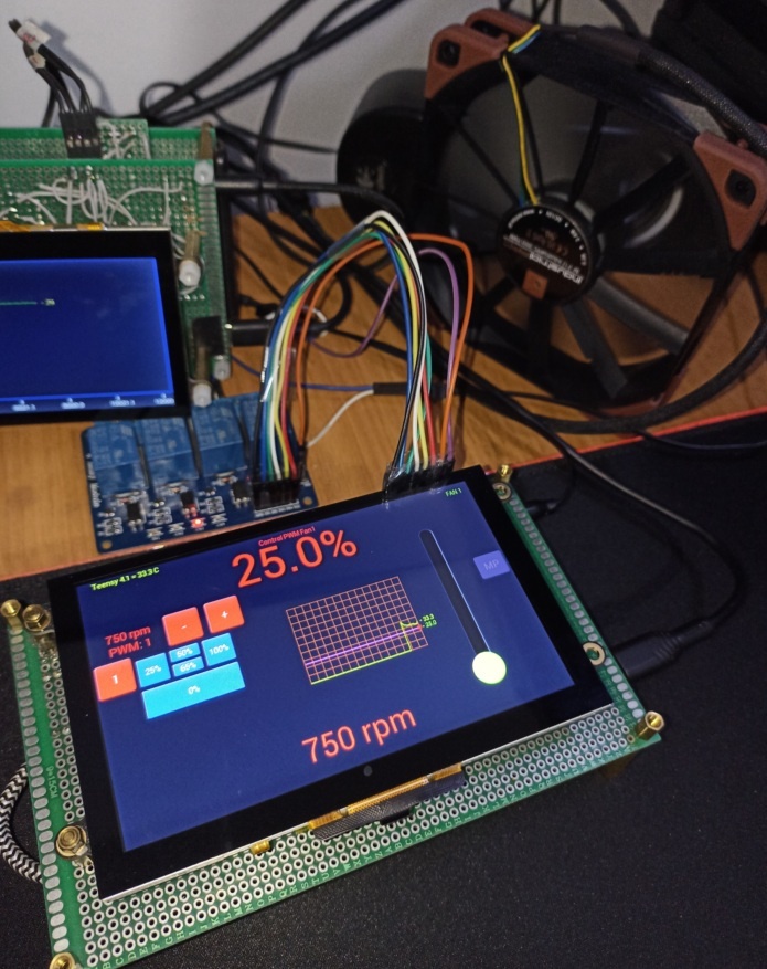

I have a couple of these modules, identical to the one you mentioned. I'll use one of them to control the PWM fans; it's being tested.
The other has been running on a Teensy 4.1 board for over two years. It controls the PC's on/off switch, a servomotor that drives the PC's folding ventilation dome, a PWM fan, and a COB LED light for desktop lighting from the PC.
You must remove the JDVCC jumper with VCC. There, you power the board with the Teensy's 5V line on the JDVCC pin
On the other header: GND-IN1-IN2-IN3-IN4-VCC, you power it with 3.3V from the Teensy 4. This group is for the control logic.
This way, the 5V power supply will be used to operate the relays, and the 3.3V line will manage the triggering of each relay. I can assure you that what jmarisma points out is physically confirmed.
