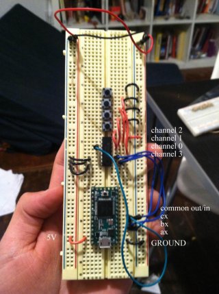

I am trying to get 16 buttons into my teensy 3.1 with as little pins as possible. I have been using the 4051 multiplexer
http://www.mouser.com/ProductDetail/Texas-Instruments/CD4051BE/?qs=q2XTDbzbm6DxulBsMcV7tA==
but am coming across some completely unexplainable (to me and a few other tinkerers at least) issues
***I am considering the possibility that the issue is actually with the teensy and not my hardware or software, because when I keep everything exactly the same, but replace the teensy 3.1 with an arduino or chipKit, everything then works smoothly***

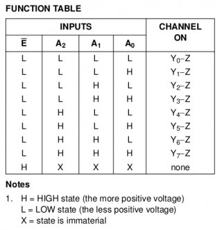

I know the multiplexers work, because when I use them as demultiplexers to consecutively power some LEDS, it works as expected.

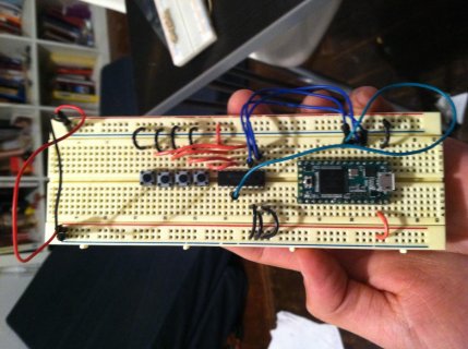

Here is a picture of my breadboard
As you can see, I am currently testing with only 4 buttons. The power for the rails is 5V from the teensy VUSB.
The code functions as follows
___
pin5 of the teensy is connected to the common out/in of the multiplexer and is pulled high with the internal pullup resistor. The 4 buttons, through the multiplexer, are meant to pull this pin low when pressed.
set multiplexer to first address - this should make a connection between the common out/in (pin 3) and channel 0 (pin 13)
read value of common pin and store to variable (b0)
set multiplexer to second address - this should make a connection between the common out/in (pin 3) and channel 1 (pin 14)
read value of common pin and store to variable (b1)
set multiplexer to first address - this should make a connection between the common out/in (pin 3) and channel 2 (pin 15)
read value of common pin and store to variable (b2)
set multiplexer to fourth address - this should make a connection between the common out/in (pin 3) and channel 3 (pin 12)
read value of common pin and store to variable (b3)
print values of stored variables in serial monitor
_____
ISSUE
what is happening is that when I read these variables, am I given a consistent, incorrect, and seemingly unexplainable response.
b0 should read high until I press down button one - which pulls teensypin 5 to ground when the address is set to the first (pin2=LOW, pin3=LOW, pin4=LOW))
this happens, but b0 also reads low when button2 is pressed (meaning that pin15 is connected to common out/in pin when the address doesnt tell it to...)
b1 reads low when button1 is pressed, but also when button0 is pressed
b2 reads low when button0, button1, and button3 are pressed
b3 reads low when button2 is pressed
this makes NO sense to me
at first thought problem was using 3.3v for 4051 that calls for 5v. now using 5v, no help.
thought maybe multiplexer just fried - however when setting pin5 to an output and wiring to LEDs instead of buttons, everything works perfectly
and the main concern - THIS WORKS PERFECTLY WITH ARDUINO WITH THE SAME PIN/WIRING CONFIGURATION

Can you check the power voltage with a multimeter?

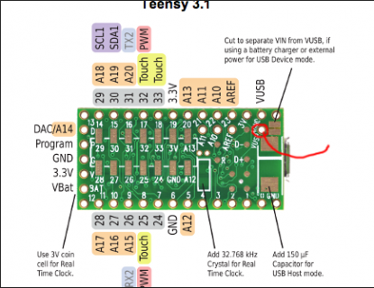

If the photo, it looks like the red wire is going to AGND. It is really connected to 3.3V or VIN (5V)?
yep 4.94 volts
I'm getting power from the VUSB pin
this isnt apparent in my previous photo because my pin header is displaced at that row- you just cant see

Its not...do multiplexers have something more complicated going on inside so that the passage of current from common pin to input pin is not simply a straight connection? Or is this an issue and possibly indicative of the problem I'm having.
Thanks!
Per my last comment - I tested with arduino instead of teensy 3.1 and still am not seeing connection between common pin and input on the 4051 with my multimeter (even though the multiplexer is working correctly).
This must mean the multiplexer is more complicated than simply making connections between common pin and input pin when it is addressed.
PROBLEM SOLVED. i was using the internal pullup resistor of the teensy for the common in/out pin, but I was powering the multiplexer with the VUSB 5v from the teensy. I stupidly didn't realize until checking with my meter that the pullup resistors pull up to ~3.2V, and this confused the multiplexer.
another huge part of the problem - faulty breadboard. I do not wish this upon my worst enemy...its been an entire week all day every day...overlooking the faulty possibility of breadboards.

i got the 8 inputs working eventually !
All i cant figure out is the correct 4051 "Channel" order to have all the buttons in proper note order eg button 1 = 60 button 2 = 61 etc etc.
I have the following chart ...
