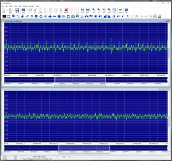

I'm sure ground loops are significant, but I'm equally sure there's a power routing issue whereby the SD card power is not starred from the source pins, but runs first to the SGTL5000.
Here's a plot with the microphone straight onto the audio adaptor so minimal lead length. The top plot is recorded to the adaptor's SD card slot, and the bottom one to the Teensy 4.1's built-in SD card slot. Same card in both cases, nothing else changed:
Note the spikes every 92ms in the top plot only, corresponding exactly to the write interval of 4k samples. I've seen them much worse, possibly due to use of stacking connectors - that rig is not available right now.

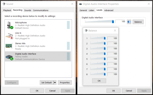

In my opinion getting 8 channels USB it's one thing but getting it without any glitches it's another.
My biggest issue is I am getting a bit of a glitching sound on USB (WIN10) regardless if I use the standard 2 Channel USB audio library or my own modified 8 channel USB audio library based on the work on some of the people mentioned here.
I'm using Thesycon USB Descriptor Dumper and here is the current output:
