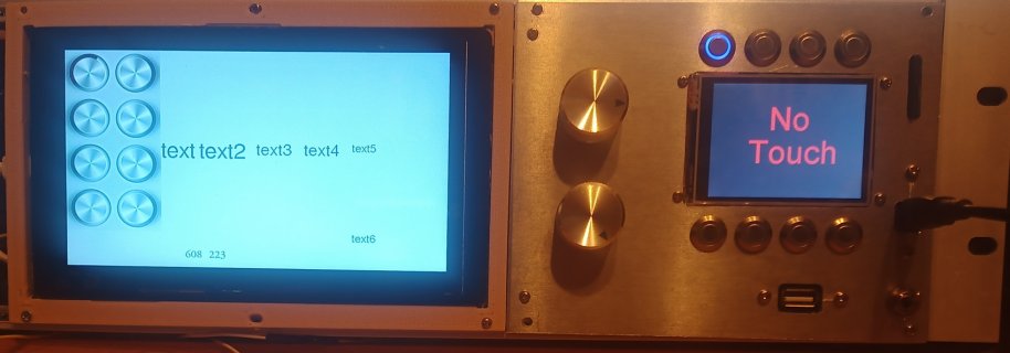

Hiya, as an alternative: out of curiosity, I recently got a 7in crowpanel HMI touchscreen display, which is controlled by built-in esp32 chip that can be programmed with the arduino IDE. Just playing with it atm, but essentially I want to eventually use it as an additional screen for the teensy 4.1. Loaded some test code into the display fairly easily, and can send info to control the HMI display over tx/rx pins. Heres a pic of it just wired rx/tx pins to a teensy 4.1, which also has an ILI9341 display. Have to unplug the tx/rx when uploading code to the HMI, though. Might be an alternative - loading alternative fonts on the HMI is straightforwards enough - on the test display I used a converted garamond font, as is loading bitmaps from the built-in SD card. Sprite functions make the screen pretty responsive. Offloading some of the graphics functions externally will hopefully save me some chunks of code and headaches :) Pretty cheap for what they are, bought mine on aliexpress. Seem to be numerous varieties of it, I got the elecrow crowpanel as it seemed to have better support and some online tutorials. Tutorials are mainly based around a HMI builder called squareline studio, but I'm just using the arduino libraries, and I just 3d printed (roughly) a bezel for mounting.

Thanks Paul, how do you find the Crowpanel screen for contrast, brightness and veiwing angals, are they OK? I have seen a review which mentions the viewing angle is very restrictive and would be good to have your feedback.
Yeah, viewing angle is certainly a little restricted, but as I'm just mounting flush in a 3U rack it's not much of an issue for me, and its no worse than a lot of other screens. Contrast and brightness seem fine, obviously dulled down in bright light/sunlight, but what I have noticed is that its pretty sensitive to fluctuations in power supply, giving scan lines on the screen, and I had to reduce the cfg.freq_write in the conf file down to 14000000 to stop the screen from flickering and wobbling. The lovyangfx library does have a function for setting display brightness, between 0 and 255, it could be that's been overlooked by some. Have managed to convert some fonts by using processing 4.3 and then an online file to hex converter, at tomeko.net. The crowpanel display seems to work ok with the arduino MIDI library, so atm I'm playing with sending it MIDI CC from the teensy over UART, which so far appears to work very nicely. If only they made a bezel that would mount in a eurocard rack, as 7in otherwise fits perfectly :). For me, a downside is that the pins for connectors are on the outside edges, rather than facing out from the back, so its a bit of a squeeze. Almost no pins for IO - got the UART, and I2C, but as that's shared with the touchscreen, I haven't used that at all. Serial MIDI is what I want it for, anyways, and reckon it's gonna be fine for that, as essentially, it's gonna be an external monitor for the teensy. I'll post a bit more when I've played with it a bit, as I've not had it long, and whilst it's not strictly teensy related as such, interfacing to a teensy might be of interest.
