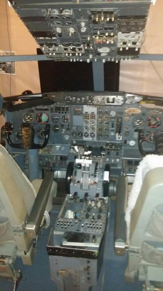

Got the throttle, control columns, Rudder pedals, and seats in, floor painted and front window frame in and painted, Next up, co-pilots side instruments wired up.

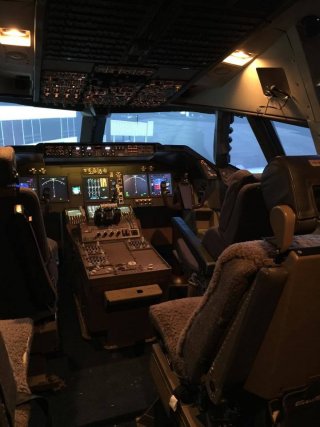

Here is my friend's 747-400 sim which I've done most of the electronics on:

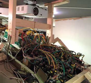

I've got a few Teensy 3.1's in there, with another 4 planned. This is in addition to many USB boards to enable every switch and indicator in the flight deck to work.
2 of the Teensy's is converting ARINC 429 to ethernet...

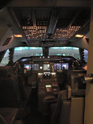

Seeing the results of it all working in situ is very satisfying:
