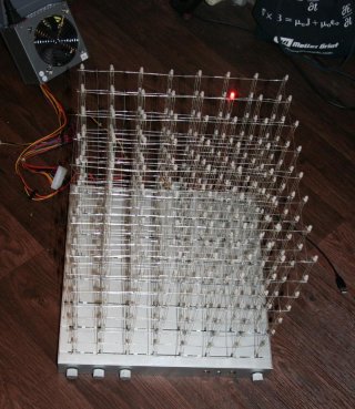

i want to share some work i did using the Teensy 3.0 and the TLC5940 PWM-driver library.
first some pictures:
Its an 8x8x8 RGB LED cube with common anode LEDs arraged in layers (as most cubes are build)

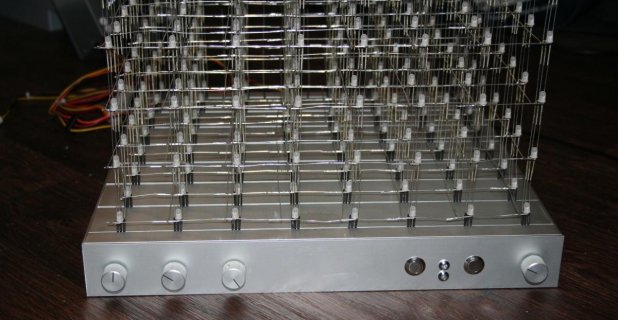

At the front there is a pannel with 4 pots (3 for color one for speed) and two pushbuttons to select the demo (and two status led (yes, there werent enough LEDs in the project))
by now it only runs some test programm that switches every LED in each layer to red one after another, then green then blue. Size is 35^3cm^3 the base is a bit bigger.
in the future i will program some more sophisticated demos, as well the playing from SD card (the SD alrady works)

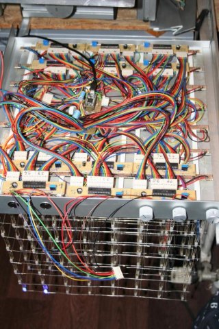

During the building i made some experience with the TLCs that i want to share with you. I am using 12 TLCs for the 3 color * 8 * 8 LEDs in each layer. I first tried to drive them with 5V as described here. However this did not work for me with more than 6 TLCs. I got some weird flickering in all the LEDs when adding more TLCs. The solution was to use 3v3 as supply volrage for the TLCs (which also matches the datasheet). If you need the higer current you can drive with 5v Vcc i recommend to use some level shifters (however i have not tried this). Another thing that occured was that when running all 12 TLCs i sometimes got some flickering again especially at the end of the daisychain. Here adding an additional Pullup to blank at the final chip solved the problem.
