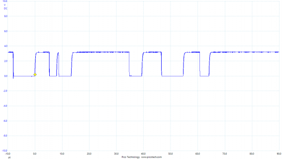

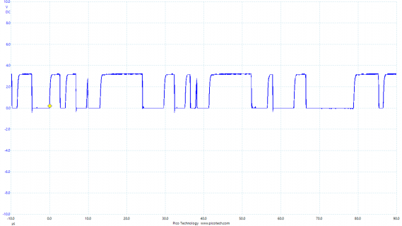

It sounds like you are saying that as long as I am above 1k1, I don't have to worry about it. But I thought I have seen scope traces of i2c signals where the sharpness of the pulses depends pretty strongly on the pullup resistor values and the commo speed. I haven't had any problems so far; I just wondered if there was a general rule of thumb. You know, 10 K for 100 KHz, 4K7 for 400 kHz, 2K2 for higher speeds, etc. Maybe not.
I thought I'd try waving a scope at the microshield and changing the I2C frequency to see how much the pulses change.
For 400 kHz and 4k7 pull-ups:
For 1000 kHz and 4k7:
So not a big difference. I didn't see any change in behaviour with the frequency change, so 1 MHz seems fine. (That's not to say it's working, there's valid communication between the sensor and the Teensy, the checksum checks, the acceleration data I'm getting has a problem but that's unrelated to the frequency.)
These pulses seem pretty square. Looks like 4K7 works well.
