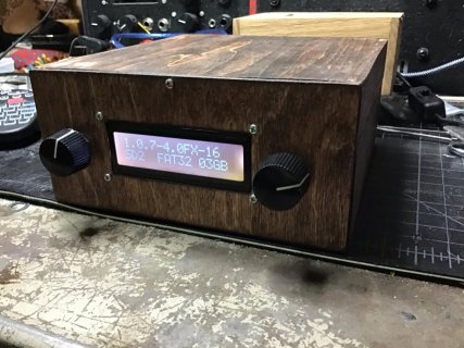

A DX7 (Fm synthesis) replacement with Dexed on a Teensy
Done!
Again, nice work, Holger!
Thanks!
It sounds like it should. To me it's a bit more Synclavier than DX7 and there's *nothing* wrong with that.
There's roughly 3000 patches in that sd card, which is delightful fun. ( some slots are blank / init sound )
Yes, sure give me a bit and I'll put something up on youtwab.
Nice work to you, ETMoody3!
How does it sound? Can you make us a video?
Sorry that there is no video demo yet. I had once run a MIDI file through the MicroDexed and the MicroMDAEPiano on soundcloud (Drums from RZ-Drummer), no additional external mastering or FX).
Unfortunately, I have absolutely no plan (and very little time) how to make a really good video that shows the synths in action.
I'm currently working on a TouchOSC->MIDI bridge, so that I can control the MIDI-CCs of the MicroDexed (and maybe its SYSEX parameters) with TouchOSC wireless from a tablet. When this is finished, I could also show you how you can turn various parameters...

Hi Holger, could you share a more detailed schematic somewhere? The resolution of the one in the build doc is not good enough to read the PIN Names. I ordered a teensy 4.1 now, since the dev code compiles for that :) I would like to try a minimal setup with two encoders, a LCD and an audio shield. I should have all the parts here...
thanks, yes. sorry i was so fixated on finding the schematic in the MicroDexed repository...
ok, built the minimal version with two encoders, a LCD screen and an audio shield with a teensy 4.1
i uploaded the dev code.
LCD and encoders are working fine, i can navigate the menu. in system there is no EEPROM option, was it removed in dev?
there is no sound output on the headphone out of the audio-shield. i have no jack connected to the line out as of now. my understanding was, that headphone and line-out are always the same signal. right? (not electronically, but what is heard) i uploaded the tone-sweep sketch to test the shield and it works correctly.

ok, the master version (non dev) works! i get output on the headphone, yeah!
it is only stable though when i use the "faster" compile command, with fastest midi is not working reliably, i get hanging notes and high pitched noises.
Hm... that's strange.
Can you try to upload one of my pre-compiled firmwares?
sure, i tried your T41, 1.0.15 and i get no sound output. strange since it works here when i compile it myself...
ok strangeness for the WIN. now i don't get any sound even with my own compiled firmware. very strange.
EDIT: it was in the System Stereo/Mono menu, somehow the firmware upload caused it to be MONO which does shutdown the headphone output...
also a funny sidenote: the small "1" and "2" to select the dexed instance are reversed horizontally on my display..
This is because you may have a wrong initial setup where both engines are set to a maximum of 0 notes, which means "off". The reversed numbers are showing this
This is strange. I never tried the headphone output. Setting mono/stereo does nothing special - only a mono-downmix of the signal.
