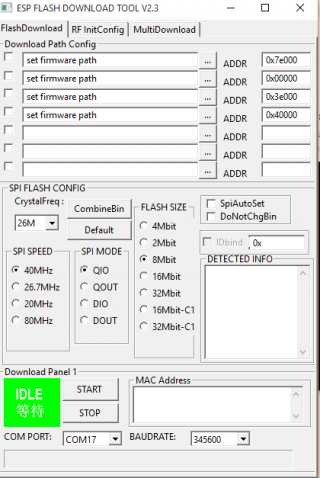

I have some ESP8266-12 boards sold by Adafruit. PCB's silksecreen is Adafruit.Yes, I did all of the obvious things. I bought these ESP8266 chips from aliexpress.com. I am beginning to wonder if they are bad or something.
When using one of the Teensy programs I get a z or an r on start up depending on the baud rate, but no response from any AT command.

I connected an FTDI USB/Serial 3.3V to the board and after a few minutes of flailing, my dumb terminal program (Bray's term) at 9600 baud was talking to the Lua interpreter. I then tried one of the lightweight IDEs (browser based). Nice. So I had some example code and my own first "hello world" via WiFi working in a few minutes.
I didn't try AT commands. Just dumb terminal talking to Lua at first. Lua is doing that lower layer.
I have yet to re-flash it for using C.
