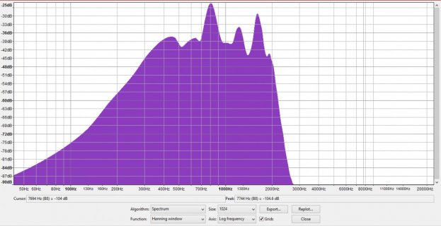

I should make a couple of comments about the algorithm:
1) Both Grandke and Jain point out the importance of incorporating enough data in the FFT. In particular they say the data record should encompass at least 20 cycles of the frequency of interest. I'm not sure that this altogether necessary, but if we look at a 100Hz signal, 20 cycles would require a record of 0.2 seconds - or 8820 samples at 44100 samples/sec. And of course 50Hz would require double that.
One way to get around the need for all this data is to decimate (downsample) the data to effectively decrease the sampling rate.
I have written a pair of Audio decimate/interpolate objects that allow down/upsampling by factors of 2, 4, 8 and today I'm looking at using decimation with the fft interpolator to look at this effect on low frequency estimation. Of course it takes longer to accumulate the 1024 samples so the update time also increases accordingly.
2) I never really intended this function to be used for musical pitch estimation. It is part of a general DSP library that I am creating for scientific/engineering/educational use. In fact, my whole interest in the Teensy revolves around developing a method for rapid development/deployment of scientific lab instrumentation and analysis methods. I see Paul's work in creating the Audio library as a fantastic framework for achieving this.
The problems I see with the blind application of the FFT interpolation method is in the nature of the musical signal itself. As an old musician (alto sax and flute), I'm certainly aware of the the structure of a musical note - including frequency changes in the onset and vibrato. I wonder about the "cleanliness" of the FFT. You folk will certainly know more about this than I do :)

Wow great work. I have a sample .wav file which i'm trying to detect fundamental and harmonics. But when i use that .wav file with you'r code it's not properly identify fundamental and other harmonics. Check out the attached .WAV file. If i analyze that with Audacity i get something like below figure.

I took a listen and did some analysis in MATLAB on your .wav file, and it's no wonder that my method (and probably many other methods) will not work on your data!
1) The audio is so bad I couldn't understand what it is, it sounds like a child's voice crying or singing???
2) The signal-to-noise-ratio (SNR) is horrendous! The Audacity spectrum also shows this.
The assumptions behind my method are that a) the signal consists of a set of isolated sinusoids (whose windowed spectra do not overlap, and b) the SNR is "reasonable" for all components.
The present version of the code is indiscriminate, that is it will produce results regardless of whether or not the signal is actually present or is of sufficient amplitude for the results to be valid.
For example, as far as I could tell the first couple of seconds in your .wav file has no signal - but if you ask for N peaks, you will get N values, and all are complete garbage! Similarly, if the noise has large peaks in its spectrum, they will also generate garbage output.
My to-do list in a previous post said that I intend to look into a threshold detector before a peak is reported. Your data indicates the importance of this.
