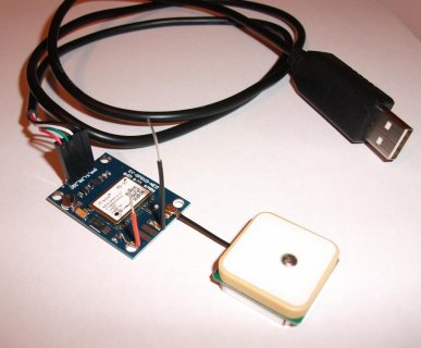

The module that you purchase needs a little skill with a soldering iron first to make an electrical output signal available, and you will also need to purchase a "USB to Low Level TTL" cable if you want to use the free UBlox "U-center" software to drive it from a PC. These USB cables require a driver download to function, and there are a few surprises in store - as a USB device - for the unwary. But I hope to guide users through these "surprises" so that they can get up and running as quickly as possible.
The following two pictures illustrate how the module needs to be modified in order to make the output signal available. These modules were never designed to have an output available, only to blink an on-board LED. But the UBlox component (via Pin 3) has this ability to control this pin signal via software, so by soldering a wired connection in parallel with the "102" resistor (that drives the LED), then you can make the pulses/frequencies available, as well as the LED. I normally solder two short wires to the module first (Orange = signal, Black = GND), and then use clip wires to connect to other devices. The output level is 3v3 so should be compatible with Teensy inputs - BUT MAKE SURE WITH A SCOPE FIRST BEFORE YOU CONNECT. I take NO RESPONSIBILITY if you damage your Teensy or other equipment !!! The responsibility for safe operation is YOURS to own ALONE. Ground returns and power supplies can throw up some unexpected situations.

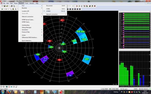

With the U-Center software running, you need to select the RECEIVER PORT setting from the main menu. Below is an example picture.
Here I have chosen the (menu option) VIEW - SKY VIEW window for the main area. Over on the far right you see the signal level sub-windows. When you first start up the software, if the module has been correctly recognised, then you will see some "Blue" signal indicators popping up. These remain "Blue" until the software/module has correctly identified at least four satellite signals. This can take quite some time from a "Cold Start". On the module itself, there is a steady power indicator LED to show that USB power is being used. Once four satellites have been "locked", then the module will start to blink its GREEN LED at a rate of one blink per second. This rate is configurable, as we shall see shortly. Also, when four satellites have been locked, the signal indicators for those satellites will change color to "Green". That signal will also now be available as an electrical output on your soldered ORANGE/BLACK wires. Check this with a scope.
