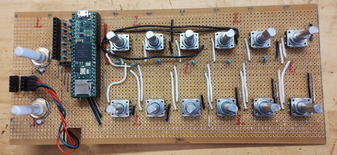

Probably too niche to be a viable product, but as a lifelong (50yrs+) Veroboard fan for one-off projects I like the dual in-line format of the Existing Teensy boards. As the standard, 100 x 500 piece of Veroboard is 36 holes wide, perhaps a 72 pin version would be a possibility? That's an extra 24 GPIO pins over a 4.1.
Would be cool - but caught this pic on another recent thread - already hard to unsocket 24 pins
Paul noted getting the needed pins escaped for the T_4.1 already tough without more layers and more costly PCB.
Though losing Ethernet would give back a dozen?
