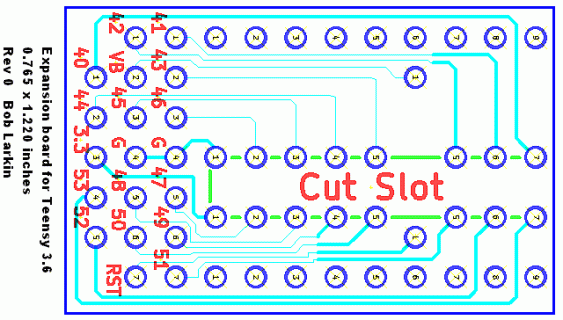

I did a conceptual layout of a new T3.6 board like Frank B's and it looks like I could pick up all 14 pads on the SD card end. This would require running a couple of traces on the outside of the main pin row (one on each side), so the extension board would be slightly wider than the Teensy 0.7 inch. If I stayed to 14 pins on the extension part of the board, like Frank did with the 3.2 board, it would meet my needs. By going to a third row it looks like it would be possible to pick up Reset and VBat. Is that of value to anyone? That same extra row could include a ground or two that never hurts to have. I think all those traces can be run without needing more than two traces between pins.

Here is a cut at a simple board in the spirit of Frank's:
This is close to being ready to go to OSH Park. It will need a hand cut slot, I think. I don't think this is hard to do, as the FR4 saws and sands with minimal effort. Comments are welcome. I am challenged for viewing things upside down, but I think it is right!
This board only deals with the pins on the SD card end. Also, as it is, it blocks bottom access to the Program, Ground and 3.3 header pins in the middle. Top access remains.

I meant to mention that, as Frank did, I put the traces all on the bottom. The view shown is from the top, though. And the pin numbers are, of course, on the top silk. The slot outline for cutting is on the bottom silk.
If I remember correctly, you can put in a rectangle into the Board outline gerber file for the cut out and OSHPark can in many cases do the cutout for your.

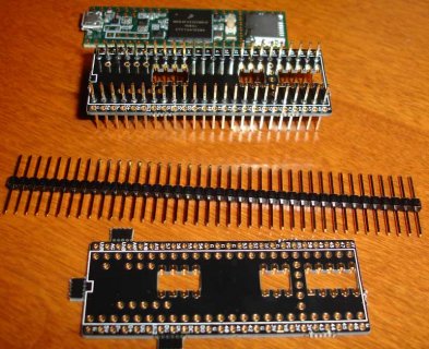

Example of the T3.6 I was playing with earlier.
My concern was cutting through the through holes. OSH Park indicates, "No copper present beneath the cutout" that might indicate a problem. Have you or others used slots with routing along through the holes? At $5 the easiest thing might be to submit a board...
Indeed Frank's board from OSH ( and other's - boards and PCB houses ) removes the PCB material before shipping. Right through the plated hole that survives intact, sometimes with a minor fold/burr of the plating wiped over depending on the cut speed and bit sharpness.

It has been awhile since I played with it. I have built a couple of the Tall Dog boards as well

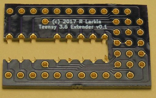

The boards came from OSH Park. They cut the slot, as specified. They will work, but there are a couple of qualifiers. When their router cuts through the middle of a hole, one side is cut cleanly. The other side has a small piece of copper hanging away from the cut. As a hobbyist issue, this can be dealt with by hand cutting the pieces off. Alternatively, and what I did, is to use a dental probe to bend the piece to open the "half hole" and solder everything to the T3.6 board bottom. Here is what the board looks like, with the pieces bent out:

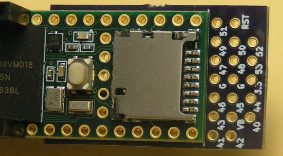

This soldered fine to the T3.6:
And the markings worked out fine:
Looking at the board under a microscope showed that a small part of the metal was sometimes pulled away from the board material, inside the half-hole. The metal was intact, but I would suggest inspecting for this, in case a break had occurred. One cannot fault the board maker, as we are asking for them to cut the slot with metal breakout, something that is not recommended.
With any of these extenders, there is an issue with making sure that the through-holes along the T3.6 edge are properly connected. There are several ways, and what I did was to put individual pins through that could be soldered on both the extender board as well as on the Teensy. I used a socket to align the pins with other Teensy pins.

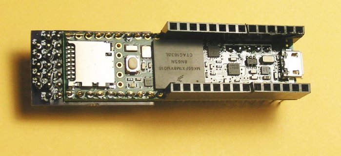

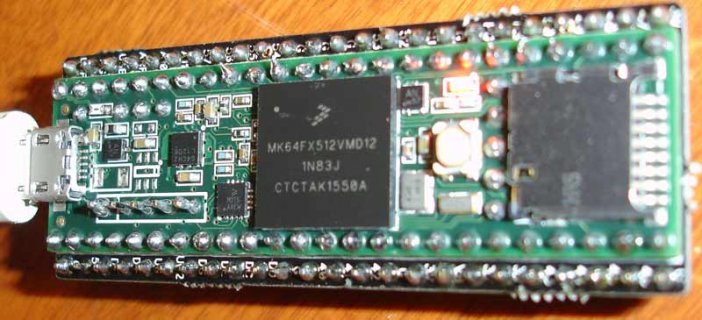

Nothing new, but here are a couple of pictures of the installed extender on the T3.6.
These are setup to allow the Teensy to plug into a main board and the audio codec board to plug from above the Teensy. Including the USB Host pins, I think it is 72 pins total. I wondered if I could get all those pins to line up well enough to get into their sockets, but that went well. I started from one end, and in a couple of cases needed to push a pin slightly. If you are trying to do this with a proto-board type of socket, install the USB pins last, as they are not on 0.1-inch centers.
What seemed to be helpful was to have the pins in a socket when they were soldered to the T3-6 or the extender board.
