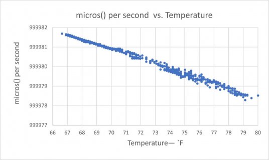

I wrote a sketch that measures the number of micros() in an accurately known period of time. I made these tests on a Teensy 3.2 but I believe the same 16 MHz crystal may be used on various other Teensy versions. I used the PPS output of a GPS module to provide a precise one pulse per second trigger and tallied micros() over a 60 second period.
A perfect Teensy would measure a million micros() in one second. The four Teensies that I measured ranged from 999980 to 999983 micros() in one second. This might be accurate enough for some applications. But if you were making a clock, for example, 999980 micros() in a second would accumulate an error of 1.72 seconds per day—nearly a minute in a month. By correcting for the actual number of micros() in a second you can greatly improve timing accuracy.
It would be wonderful if the micros() error were constant but it varies with temperature. I made the same measurement over a range of temperature from 67 ’F to 79 ’F. Temperature was measured with a thermistor connected to an analog input on the Teensy. The data show fractional values for micros() per second because it is averaged over a one-minute period. With these data, it’s relatively easy to correct for temperature variation in software. Of course, each Teensy may have its own unique error and temperature variation.

For a clock you'd probably need the battery-backup facility of a RTC chip/module anyhow so you'd pick one of those with the desired accuracy in practice
It's pretty common for microontroller based systems to pick a standard 25ppm or 50ppm crystal as this suffices for many uses and such crystals are cheap and small and are jellybean parts (in times of shortages this matters!). On a larger board with space for alternate footprints you can make it possible to substitute different crystals and oscillators more flexibly, but the T3.2 (and Teensy's in general) isn't gifted with a lot of spare area, the clue is in the name... It would be nice to have a high-spec TCXO on the thing, but not many people would like having to pay the price for something they never need.
I'm sure someone's managed to do some hot-air rework and replace the crystal with a better one or a TCXO (if there's a footprint-compatible one), which is one route to go.
When I use a Teensy 3.2 I solder in a 5ppm 32khz crystal (citizen CFS-20632768HZFB) and use a 1F super cap tied to the RTC battery input. The super cap is charged via a schottky diode tied to 3.3v. I've found it keeps the RTC running for several days without power. I sync the on-board RTC with either GPS or NTP and measure the drift while the clock is powered. I periodically use the rtc_compensate() function to trim the RTC. I pick up the RTC seconds using the RTC_TSR register and fractional seconds using the RTC_TPR register.
