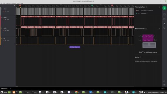

I'm just curious if anyone has used this AD7124 24-bit ADC at higher data rates, for example 1 kHz or above. The Analog Devices AD7124 datasheet claims it is capable of sampling rates up to 19200 sps.
Using the "continuous conversion" mode and whether or not I wait for a sample to complete, I get at most 320 samples per second, no matter what sampling rate I select, down to "1" which is maximum speed. I also tried only printing out only every 100th result, or printing nothing at all, in case there was a problem with USB overhead. I'm using a Teensy 4.0.
Looking at the /CS and Clock lines with a scope, I see the chip is selected for 41 usec every 1.033 msec. Some reads are 3 bytes, some 5 bytes, some two sets of 5 bytes. Apparently, only every third or fourth transaction ends up reading out a value.
My testing code is below.
