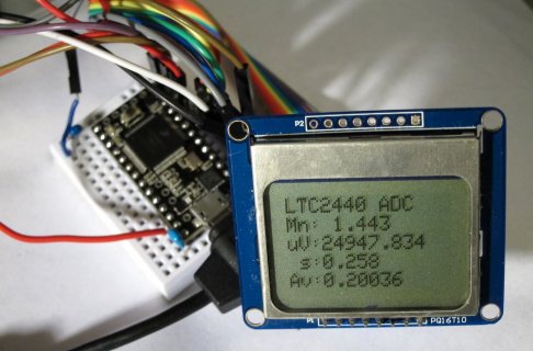

Example of T3 driving LCD display
Yep, still don't know what they did with the newer lib- too fancy for me :). Anyway, just to demonstrate it works, here's my project for this evening, a display to show the reading of my 24-bit ADC. The sketch is also attached in zip.

Thanks cmason for the library fixes for Teensy 3, I did them here and I confirm that it compiles and works as expected on my Nokia 5110 display.
EDIT... and I see the syntax of the library has changed a little bit too. Just for my own reference, attached is my ADC display application using the new library ("clear" became "clearDisplay" etc.)
  • LCD_LTC2440.zip

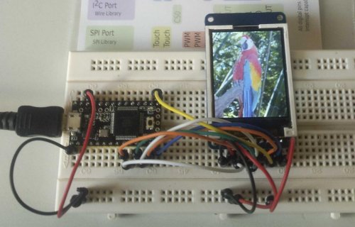

cmason, awesome work on fixing Adafruit_GFX. :)
Have you submitted a pull request? It'd be really nice to get this merged back to their code base.
On TWBR, I'm considering adding it to avr_emulation.h. It's the one AVR TWI register that's easy to emulate.
A quick follow up: I swapped my SPI display out for the equivalent Adafruit breakout in I2C and it works, even with the commented out TWBR lines. However, it is extraordinarily slow--I write to serial once per loop and using software SPI feels at least 4x as fast as I2C. Perhaps since the TWBR lines are referencing hardware registers things will speed up once they're emulated. But just wanted to report what I'm seeing in case that means anything.
Thanks to all who got this working!
