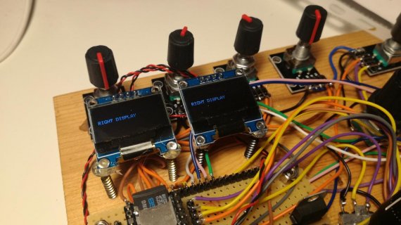

Hi all,

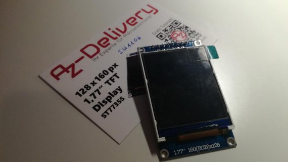

In my project, with the amazing Teensy 3.6, I'm using #2 I2C OLED displays 32x128, cause I'm not able to make this guy work:
One display has its original I2C address 3C, the other 3D (obtained by changing the position of a 4.7K resistor on the small board).
I'm facing an issue even with this super simple configuration...
Does anyone know why using in this test code:
after 2 seconds both displays demand to be the only "RIGHT DISPLAY"?
I'm supposing that ONLY .begin and .display functions are "address sensitive"... Is it possible?
Thank you!

#include <Adafruit_GFX.h>
#include <Adafruit_SSD1306.h>
#define SCREEN_WIDTH 128 // OLED display width, in pixels
#define SCREEN_HEIGHT 64 // OLED display height, in pixels
#define OLED_RESET 4
Adafruit_SSD1306 display_R(OLED_RESET); // Adafruit_SSD1306 display(SCREEN_WIDTH, SCREEN_HEIGHT, &Wire, OLED_RESET);
Adafruit_SSD1306 display_L(OLED_RESET); // Adafruit_SSD1306 display(SCREEN_WIDTH, SCREEN_HEIGHT, &Wire, OLED_RESET);
#if (SSD1306_LCDHEIGHT != 64)
#error("Height incorrect, please fix Adafruit_SSD1306.h!");
display_L.begin(SSD1306_SWITCHCAPVCC, 0x3D); // I2C address 0x3D for LEFT display
display_R.begin(SSD1306_SWITCHCAPVCC, 0x3C); // I2C address 0x3C for RIGHT display
display_L.clearDisplay(); // clears Adafruit logo
display_R.clearDisplay(); // clears Adafruit logo
display_L.display(); // empty screen
display_R.display(); // empty screen
display_R.setTextSize(1);
display_R.setTextColor(WHITE);
display_R.setCursor(0, 30);
display_R.print("RIGHT DISPLAY");
delay(2000);
