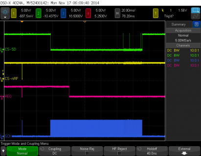

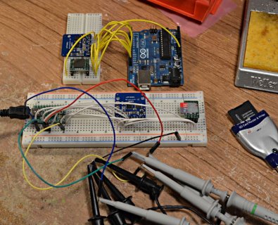

I'm working on this now. It's a tough problem. I hope to have a real fix soon....
At the moment I'm working with a modified program using SD instead of SdFat.
It's looking like the solution is going to touch a lot of stuff.... a fix inside SD, fixes in SPI.h, an addition in avr_emulation.h, and of course edits to Adafruit's library.
This SPI transaction stuff is all still pretty new. Really digging into this has exposed a number of small problems, which weren't apparent when working on CC3000 and RadioHead (the other 2 interrupt-based libs that have been ported to use SPI transactions).
I'm still working on a complete fix. It's ending up touching a lot of code. I've just pushed what will hopefully be the last edit needed in nRF8001.
Fixes are needed in SPI and SD. I'm testing those fixes now. This will also need EIMSK support in avr_emulation.h on Teensy 3.1, which I hope to do within the next day or two.
Installing all parts of the fix will require an error-prone process of updating many files. I might just make a Teensyduino 1.21-test1 installer with all the stuff.
Ok, I think I now have a truly effective fix. So far, I've tested with SD, not SdFat, but it seems to be working. That's the good news.
The bad news is a lot of stuff needs to be updated. Fixes were needed in all 3 libraries.
https://github.com/PaulStoffregen/Adafruit_nRF8001
https://github.com/PaulStoffregen/SD
https://github.com/PaulStoffregen/SPI
For use on Teensy 3.1, you'll also need to update avr_emulation.h & avr_emulation.cpp
https://github.com/PaulStoffregen/cores/blob/master/teensy3/avr_emulation.h
https://github.com/PaulStoffregen/cores/blob/master/teensy3/avr_emulation.cpp
These updates will really only work on Arduino 1.0.6.
I've sent the SD fixes to the Arduino devs, and the SPI fixes are being discussed now, so hopefully Arduino 1.5.9 or 1.6.0 will "just work" with the updated Adafruit_nRF8001. Of course, exactly what Arduino publishes is beyond my control, so trying to contribute the changes back is the best I can do.
If you're able to apply these many fixes, please let me know how they work for you?
