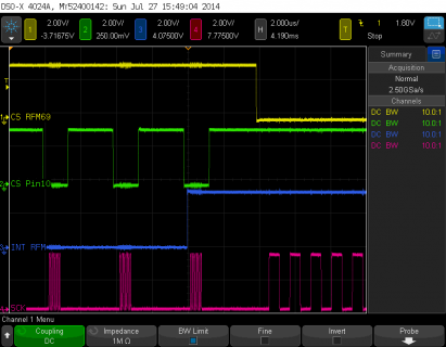

I've been working with the RFM69 and Ethernet for the last few days, and I've run into a lot of problems where SPI activity from Ethernet interferes with the RFM69's ability to receive.
At this point, I'm still not sure exactly what's causing the trouble, but today I built a digital circuit to force the SCK signal low when the RFM69 chip select is high. Somehow, that makes things start working! Here's a more detailed explanation.
http://www.dorkbotpdx.org/blog/paul/rfm69_wireless_spi_bus_sharing_feedback_wanted
I'm really starting to wonder if the RFM69 has some sort of hardware issue, where SCK activity while NSS is inactive causes trouble?

Steve, do you have any source code I can copy into Arduino and run?
I modified my test to not use Ethernet at all. It simply sends a 0x00 byte on the SPI (no device connected), then calls RadioHead rf69.recv(buf, &len), until either a reply is received or a 40 ms timeout. Normal reception takes only 3 ms.
The other board running rf69_server blinks, so I'm sure the other radio is receiving the request and sending a reply.
With the 4 SPI signals connected directly to the RFM69W, it fails. With the NOR gate circuit, the RFM69W receives the response.

The weird thing is sometimes, maybe 1 in every 5 to 10 tries, the RFM69 does hear the reply. When I comment out "DO_OTHER_SPI_ACTIVITY", all replies are heard. I have the 2 boards and their wire antennas only about 6 inches apart on my desk.
The good news is the SPI transaction code appears to be working. Here's a scope screenshot.
attachment.php
The blue trace is the RFM69 interrupt. Here you can see it requested the interrupt while the DO_OTHER_SPI_ACTIVITY code has its chip select asserted. That SPI code in loop() was able to complete and de-assert pin 10. Then RadioHead asserts its chip select (yellow trace) and begins SPI communication with the RFM69. RadioHead configures a slow SPI clock, and you can see each section of code is getting its requested clock speed.
At this point, I believe I'm going to stop working with the RFM69, and at least for now conclude there's some sort of hardware problem with this chip, unless someone sends me a test case.

RadioHead's SPI clock is configurable.. I use 8MHz. You may have taken the default for the RadioHead class constructor which is 1MHz.
Do you want my code? All I'm doing is disabling the receiver via a mode change, so that the SPI port can be used for other purposes. Avoids the condition. That's simple, and is what I plan to use until shared SPI is mature.
Versus what I sent you, above, the difference seems to be that I did the SPI transfers without an interrupt request pending from the chip. I can do that in the sample code snippet I sent above - I think, by forcing the added condition that the RFM69's interrupt request is true but not taken, when the SCKs occur, and with CS false. If you like, I/we can try this by transmitting something with the radio, which leads to an interrupt request, and arrange to have the pin interrupt disabled. As you've done, but in a simpler case. It would seem that the radio or any other SPI device just sits with the interrupt request on, waiting for CS to go true.
Odds are this isn't a chip bug, due to it being in widespread use since 2009. But, stranger things have happened.

This is really starting to look like one of those stranger things. That's why I'm hoping to find ANY code that anyone has used with these modules which talks to another SPI device while the module might receive incoming data over the air. Has anyone written and published such code?
Look at my code on reply #12. All it does is repetitively call rf69.recv(). If that extra code is added, which merely does SPI.transfer(0) while the RFM69 isn't selected, the RFM69 will usually not generate any interrupt when the other radio sends a message.
Running that same exact code with the logic gate circuit to force SCK low at the RFM69 makes it work. That's really starting to look like a hardware bug in the RFM69.

Interrupt edge detection is very reliable. It's implemented in hardware on both AVR and ARM, with proper pending bits that cause the interrupt to later be service if the edge occurs while interrupts are masked or disabled.
But in this case, the RFM69 clearly is not raising the signal at all, so HIGH vs RISING would may no difference. It stays low the entire time when the problem occurs. HIGH might be better than RISING in other cases (or it might be worse), but in this case, neither would do any good, since the scope clearly shows the signal is staying low the entire time.
I doubt 1 vs. 8MHz affects anything, unless some chip specs re setup time or some such, but 1MHz would not be worst case of course.

could you please clarify what doesn't work correctly with the transaction test?
If you run the code from reply #12, with another board running the rf69_server example within close range, it works perfectly when DO_OTHER_SPI_ACTIVITY is commented out. In that case, it's pretty much the same as RadioHead's rf69_client example.
Adding the DO_OTHER_SPI_ACTIVITY causes it to send a single byte on the SPI bus between each call to rf69.recv(). You don't actually need any other SPI chip connected. It just transmits an extra byte on the bus that isn't heard by any chip. The RFM69 should ignore it, since its chip select is high (inactive) while that byte is sent.
But if you run this test, you'll see that extra SPI activity impacts the RFM69 pretty hard. It rarely receives data. If you watch the SPI with a scope or logic analyzer, you'll see the RFM69 generates 2 interrupts in the working case, one which indicates transmit complete, the other indicates data reception. In the DO_OTHER_SPI_ACTIVITY, the RFM69 simply does not raise the pin again for reception. It's not a matter of the SPI communication failing to read the data, because the RFM69 simply never generates the 2nd interrupt to tell RadioHead to read the data.
Post #13 shows the interrupt request true (a logical 1 at the I/O bit). (Many of the other radios have a logic 0 for interrupt==true).
RadioHead uses attachInterrupt(interruptNumber, isr0, RISING); in RH_RF69.cpp, near line 100. I didn't write this library. I do not know why Mike used RISING instead of FALLING.
As to edge detection for interrupts... I recall LPC2106/ARM early versions had a bug w/errata on conditions where the interrupt was lost
Freescale's chip does not have this errata.
Even if it did, watching with an oscilloscope clearly shows the RFM69 isn't sending a rising edge when the data should be received, in the case where DO_OTHER_SPI_ACTIVITY is used.
Also, please know that for me, and others, most of the higher speed radio configs of the RFM69 cause a packet error rate far too high. And some modulation orders don't work at all. We hope these are just errors in the config coding tables in RFM69.cpp and .h.
4800bps in a 5KHz channel is most often used in operational settings. Using reliable datagrams (error corrections via ACKs and retransmissions), 9600bps and a bit higher work OK. The RFM22 radios (different silicon vendor) didn't have this problem. So I suggest keeping this failure to receive packets even at ideal signal strengths - separate from the SPI symptoms. Perhaps the anomalies you see with radio operation aren't showing this symptom.
None of the pages selling RFM69 modules or products mention this!!!
I'll give this a try when I use the RFM69 again. Unless you or someone else sends me a test case or other really useful info, I'm setting the RFM69 stuff aside for a few days.
My ultimate goal is improving the SPI library. I've spent the last 5 days digging into the RFM69 problem. At this point, I've pretty throughly investigated what the software and hardware are doing.
Unless you or someone else sends me a new test case or other useful info, I really don't see how pouring more time into the RFM69 and RadioHead is going to be useful for wrapping up this work on SPI transactions.
Indeed. I had suggested that instead of RISING, using HIGH would lessen the chance of issues. FALLING wouldn't work, as the interrupt service has to be triggered when the request goes HIGH, in order for the ISR to run, at which time it will read the status thus causing the interrupt request to be set false (LOW). Changing this is grasping at straws, indeed. But simple to try, in a process of elimination of causes.
