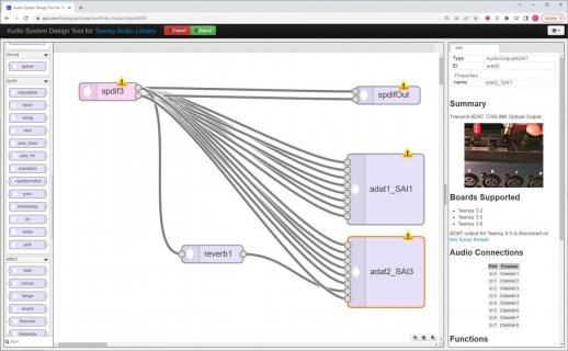

// -- GUItool: AudioOutputADAT --> adat1 --
// T3.x - T4.x Implemented Mute/Unmute on all 8ch. ADAT
// adat1.mute_PCM(bool mute); // 1 mute - 0 unmute
// Implemented Teensy 3.x - 4.x simple way to change the samplerate of ADAT at runtime.
// NOTE: 44100(default) or 48000 ADAT Only 8ch, No ADAT SMUX II-IV yet.
// !!! But be aware that not the entire lib will work. Not all parts of it support that!
// adat1.set_Freq(44100);
// adat1.set_Freq(48000);
// This needs edit in output_adat.h public: class
// void set_Freq(int freq); // change the samplerate of ADAT at runtime, 44100 or 48000 only!!!
