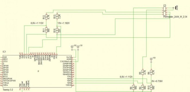

I use ADC example : "analogDifferentialRead'.
Without any change in code, when I apply ~11,5V on the resistor divider (A10-A11), I have :

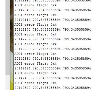

ADC Error 0x04 on Teensy 3.6 but not on 3.2 with continuous differential read - why?

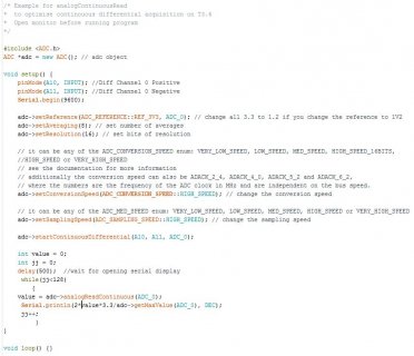

I am trying to use software adapted from Pedvide example "analogContinuousDifferential Read" on the Teensy 3.6 but with just a single 128line acquisition in "setup" (see picture) and with the "loop"Mod.JPG commented out. It works fine collecting a signal on A10 and A11 on the Teensy 3.2 with the internal 1.2V ref and various other parameter settings. However, when I try to use the same software on the 3.6 it fails, telling me error 0x04 has been commited. I can't find this error in the ADC.h and wonder what has gone wrong. I am using a battery-powered signal generator with a 200mV 200Hz signal on A10 and floating 0V on A11.
The errors are in ADC_Module.h, but more importantly is that that's a bug in the library for the Teensy 3.6!
Please, go to https://github.com/pedvide/ADC/tree/dev and use that version of the library. There are a few changes with respect the old version in the setReference, setConversionSpeed, and setSamplingSpeed methods. They now use an enum class instead a define, so for example, if before you had:
adc->setConversionSpeed(ADC_VERY_LOW_SPEED)
Now the syntax is:
adc->setConversionSpeed(ADC_CONVERSION_SPEED::VERY_LOW_SPEED)
The code in the examples has been update if you need help.

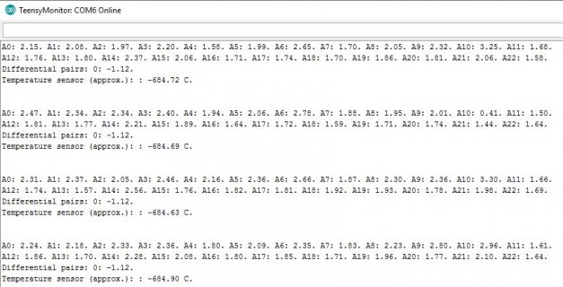

Could you test the example readAllPins.ino? Make sure that the values read for the A10, A11, and the differential A10-A11 are correct.
I had problems in the T32 in using the dual synced ADC. I had to select two channels whereby both ADCs are used. Does this same situation apply when using the differential mode.
Thank you very much for the help. I managed to install the new T3.6 code and ran the readAllPins.ino as requested but without changing parameters or the code. All the pins are unconnected except A10, A11 across which I have +0.4V from a battery sourced pot, with a 0.1mF across its output. Here is a snapshot of the readings. The differential reading on A10, A11 is negative and too high by a factor of 3 and the temperature reading seems high (!).

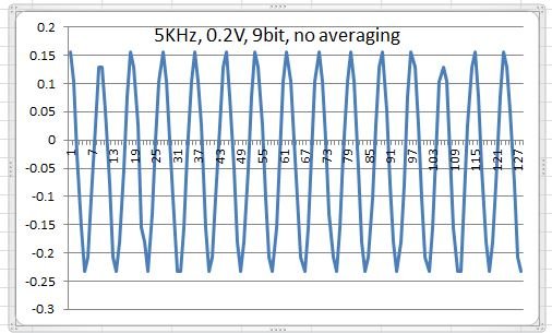

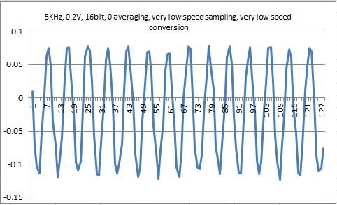

I also gutted your analogContinuousRead.ino to find the speed of acquisition with a 5KHz 0.2V sine signal on A10, A11 using the version below.
I got the following output, displayed using Excel, which shows a sampling rate of about 45ksps, adequate for my purpose but not as fast as I expected.
Will the ADC go faster?

You can go faster, you will sacrifice accuracy to do it. You can increase the sample/conversion speeds(VERY_HIGH_SPEED instead of HIGH_SPEED). You can also reduce the number of averages. (adc->setAveraging(4) instead of adc->setAveraging(8))
1/45000 = 22.22222uS
22.22222u / 8 = 2.77778uS per sample.
or 380Ksps

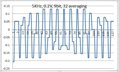

I have also examined the other speed factors. The examples above (including the 16 bit result in my previous posting) were acquired with high speed sampling and conversion. Increasing either or both to "very high speed does not increase the sampling rate, it remains 45ksps for all. I believe I have read that this will be so in one of Pedvide's notes.
It appears too, that setting "very low" and "low" speed parameters for sampling and acquisition make no difference to actual sampling rate, which remains 45ksps. Which puzzles me...
I'm happy with the speed. Reading ADC.h in detail indicates that my expectations may be based upon misunderstandings. However I have now successfully recorded an AC signal (see image below)

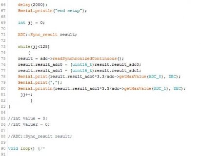

Failure to get T3.6 continuous synchronized differential outpout
Here is my best shot at getting synchronized continuous differential measurements using a T3.6 (180MHz clock).

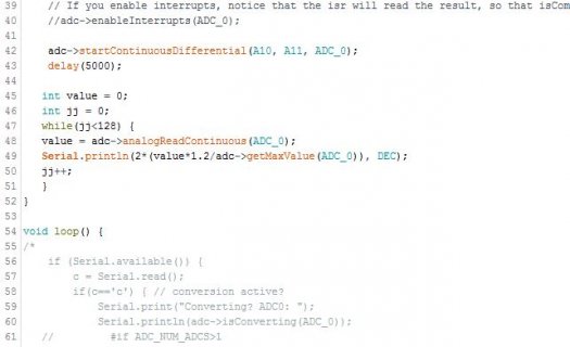

I'm looking into these issues, but I have a lot of work. I hope I can do something on the weekend.
Please note that Teensy 3.6 only has one differential pair!
Also I see that you're casting the results to uint, so you won't get negative values, which are possible for a diff measurement.
Also, what happens if you run that while loop inside the loop() function?b
Also, in the loop you're printing every value as you read it. This means that the 45 ksps may very well be because of the constant sending of a value via usb and printing it. Better fill an array and print it at once.

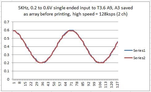

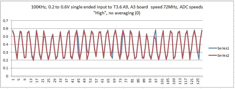

Pedvide, thanks so much for your excellent advice. I have rewritten the test program (below) to separately save the data as an array and then print it. I have not yet got the full resolution in the print out but plotting the output:
shows that the print instructions did indeed slow the ADC's dramatically. They are operating on both channels at about 130ksps now. This speed makes all sorts of things possible...
Here is the program without comment lines:

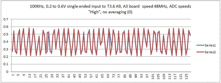

Note that the speed was measured at a board clock of 48MHz. Increasing that to 180MHz approximately quadruples the ADC speed to about 1/2 cycle (5kHz) in 128 lines of data or about (1000/0.25)*128 = 0.5Msps, approximately - a number consistent with Pedvide's test results in his "analogContinuousRead.ino example. However, plotting results shows that for board speeds of over 72MHz there is doubling or tripling of identical ADC values and the effective Nyquist frequency seems to be just above 100kHz as in this example obtained with a board frequency of 72MHz (see below).
