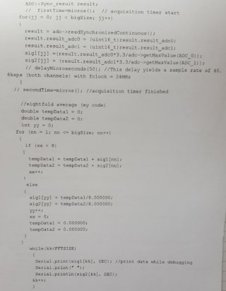

I have experimented with "setAveraging(x) on my T3.6 and found that it makes an x-fold average of each x number of lines of data then puts that average value on all of the lines to which it applies - not useful - it produces a staircase of identical values and an x-fold reduction in lines. Instead, and taking advantage of the T3.6's memory I collected over 8-times more lines of data with setAveraging(1) than required then did an 8-fold average using this code: av.JPG. This works to increase the effective resolution of the signal - more like real 16 bit data, although it also produces an x = 8 fold reduction in lines per second.
If im reading the library right there is no setting for "adc->setAveraging(2);" so most likely it reverts to 4. The allowed values are 1, 4, 8, 16, 32.
@randomrichard, what it does is read the ADC channel multiple times in a row and then average those values using the internal ADC hardware.
Try setting your averages to 8 and your ADC resolution(s) to 16, then remove your averaging math. The result should be roughly the same.
Another thought randomrichard is to bitshift instead of divide, division is very slow even on the Teensy.

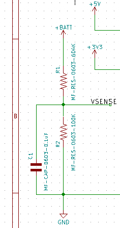

If you want to measure the supply voltage, the most straight-forward way is to create a resistive divider, and buffer it with a 100 nF capacitor. You can make the resistive divider quite high impedance to avoid draining the source, as long as you don't read it too often. The parallel capacitor will make sure the ADC sees a representative voltage.
This example uses a 604K upper resistor and 100K lower resistor, for a drain at 12V in of 17 microamps. The time constant for 604k*0.1uF is about 60 milliseconds, so if I read this no more often than every 500 milliseconds (half a second) it should be quite stable. If you're OK reading even more slowly, you can probably go to megaohms of resistance, although you start becoming susceptible to pick-up EMI noise at some point.
(FWIW, the circuit below generates 3.3V in to the analog input when the battery voltage is 3.3V*(704/100) or about 23.2V, so it's safe up to about 5S LiPo input. If you want to push it all the way to "absolute max" (which I think is 3.6V in the data sheet) you'll see 25.3 Volts so 6S probably won't kill it. If your actual battery is lower voltage, you can increase the lower resistor to gain resolution and lower leakage.)
Finally, if you want to measure the voltage, I suggest calling analogReadRes(12) to get a better resolution measurement.
Not quite. I want to run the teensy off a battery with not more than 3.6 V, probably without the regulator in between. So the controller's supply voltage is not known as it would usually be. That's why I want to compare it with a known reference, hence my question.
The time constant is much faster then you think. The formula for the series resistors connected to a capacitor is Rtot = (R1 * R2) / (R1 + R2), not just R1.
So for a 604K/100K divider the total resistance is around 86.5K. Making your time constant about 8.65mS with a 0.1uF capacitor.
For trying to get the capacitor down to ground, I can see how the time constant could go to "parallel resistors" resistance. Thanks!
Anyway, that just means you get a more settled reading at 500 ms. The main point is to have a big enough capacitor to feed the ADC input when it actually samples, while having high through resistance to reduce current consumption.

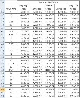

Been poking around the library, mainly looking at speeds and such and noticed some inconsistency's vs the ADC Code Paul provides for the Teensy. Here is the Breakdown table for FBus to ADCK. For both the stock analog.c and ADC_Module.h
108Mhz has some math issues and 36Mhz seems to be missing 4.5Mhz.

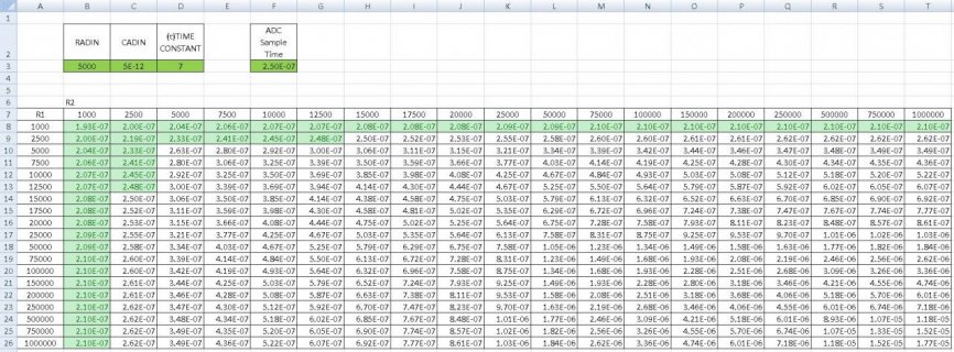

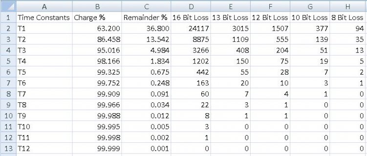

On another note I was playing around and created a small lookup table for selecting resistor values for a divider. The values indicated are safe to use with or without an external capacitor on the divider. Although you may have noise issues without the capacitor.
Just set the Time Constant to the value you want and using the table provided(values are calculated sample time for the ADC), insert the sample time your after and it will highlight all values that are safe to use. The pictures show the usable values for a Time constant of 7 and a 250nS sample time(24Mhz @ Very High Speed). You can change RADIN and CADIN if you want, both are set to worst case single ended read.
Link to the Excel file on my Google Drive.
