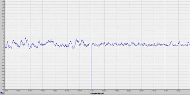

I'm using a teensy 4.0. Is there a reason why I'm getting twice the noise if I choose to read certain combinations of analog inputs simultaneously? I'm not quite sure what's going on, I'm reading all sensors, two at a time like this:

It seems I get inconsistent results. When ever I recompile and get more noise I recompile using a different combination of two sensors and usually it cleans up. I haven't noted which combinations work and which don't or if it's completely random.
Is there a best combination of analog inputs?
It's not an anomaly, we are talking literally twice the noise. And the noise is 1/f noise.
Here is a picture showing a filtered analog read of an analog input while at the same time another input is being read but not shown here. The only difference between the left and right on the picture is I changed the other analog read input. So if I for example read A0 and A1 I may get noisy readings on A0 and if I change to A0 and A2 I may get low noise on A0.

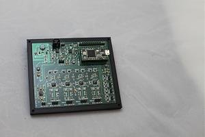

And here is a picture of an SMT board that I built for low noise. You can see some of what is involved.
No the different speeds is a typo. I'm usig the same speeds.
It's an SMT board which I designed to the best of my ability. I'm not dissatisfied with the noise I just want it to be consistent.
What would it be on the board that would give inconsistent results? I'm not sure that it's the switching of analog inputs or if it's just inconsistent?
Note that this is a very filtered signal and what you see is 1/f noise zoomed in.

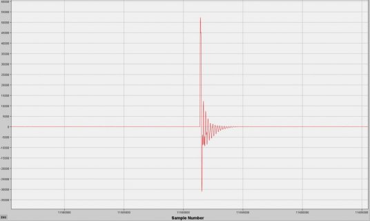

Here is a more common signal:signal.jpg

Well that is interesting indeed. So the ADC's are configured identically (averaging, speed, amplifier, etc)?
The engineers at NXP are pretty knowledgeable, it would be a big surprise if the two ADC's had significantly different noise.
Nonetheless, my next step would be to compare the noise from the same channel using each of the two ADC's. I recall that the library has calls to read an input with a specific ADC, and that there are a few specific channels that can be read by either ADC.
P/S What do you mean by filtered signal? In circuitry or software? Can we see the unfiltered signals?

Yes same configuration on both channels. The signal I showed is low pass filtered in software. It is a 1.25V DC signal from a voltage reference although you are seeing it as 0. I didn't take a snaphot of the unfiltered signal but it's visible there as well. The noise is the same peak to peak but it switches to the neighboring values much more often.
You are misunderstanding, the ADC's don't have different noise. They behave differently depending on which two analog inputs are selected. Sometimes if I read 10 sensors, 7 of them can look very clean and the other three are misbehaving. If I switch the order of the ADC acquisitons and switch them around I can maybe get 9 of them to look clean.
This is the same on breadboards, SMD PCB's, through hole PCB's. I've only tried it on teensy 4.
It would seem the order of the ADC readings and/or which two are sampled together seems to affect the quality. However I'm not sure it's consistent, I need to write down which analog pairs work well together and test if that's always the case.

If both the noise and the 60 Hz pickup change by a factor of 2, that sounds like the different sampling configurations are somehow either changing the effective impedance of the ADC input at those frequencies, or simply the actual overall gain of the channel. Is it possible there is a single-ended vs. differential mode being used? Seems like there should be a way to measure that systematically.
I succeeded in setting up the ADC + DMA library example on a Teensy 4.1 for continuous conversion of a single pin. Is it possible to extend that to multiple pins?
I come from ST microcontrollers and there it is pretty common to have an adc buffer with length = number of pins to measure and let the DMA transfer the ADCs results continuously. That way you can access the latest ADC measurements whenever you want in your code without need to worry about timing.
